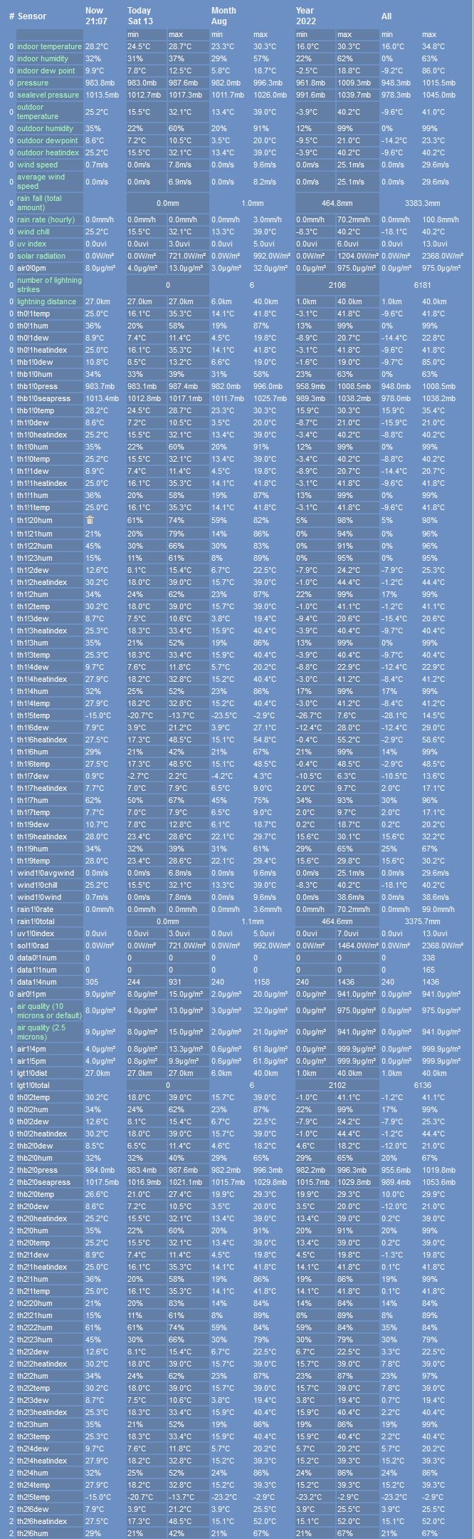

In the Raw Sensor data tab all sensors from all stations are shown - HOWEVER in the Min/Max Historical Data tab quite of few of the sensors of the 3rd station are missing even though they have already provided data.

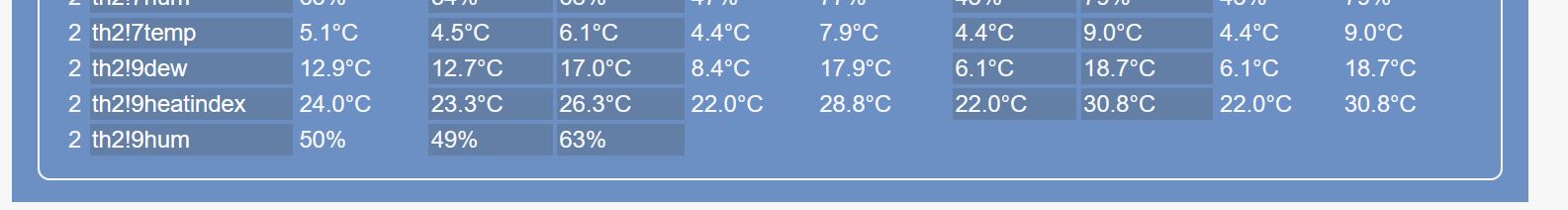

Apart from the fact that I never understood how this table is sorted (roughly 0 --> 1 --> 2, but some 0 and 1 (station #) appear out of alphabetical sorting sequence, sometimes only at the end of the list), the 3rd station data appear truncated - only sensors starting with "th" are shown - no air quality, no wind, no solar, no lightning, just only sensors whose name starts with "th". Station 0 and 1 sensors are complete.

maybe I should add a picture showing the issue - only sensors starting with "th" in the list for station 2, station 0 and 1 complete.

I did a count now and it appears that even for station 0 not all sensors are shown in Min/Max.
As you can tell from complete shown list, there are
29 entries station 0
57 entries station 1
33 entries station 2
0 entries station 9
119
There should be
57 entries for station 0
57 entries for station 1
59 entries for station 2
7 entries for station 9
180
the raw sensor data show 25 sensors for each station (except station 2: 26 rain0 and rain1) and 7 for station 9 and all providing data.

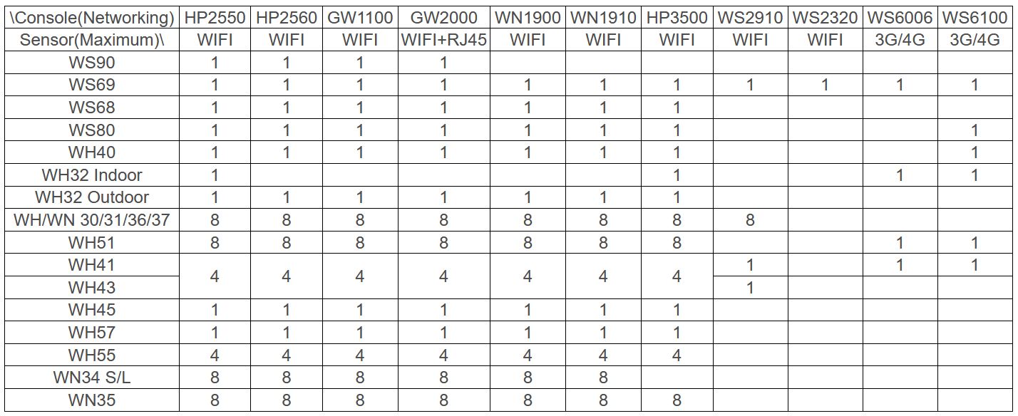

As for Ecowitt (clone) stations there is a list of maximum number of sensors per console - MB should be able to serve them - also for 3-5 stations 8)
For most consoles it's 56 sensors out of which some are 2-in-1 plus combo sensors (WH32B/indoor 3-in-1, WH45 5-in-1); => the max number of possible observations is much bigger: +/- 64 - in addition come the derived/calculated values like dew point etc. So the max number of observations for an Ecowitt station with all possible sensors will be around 80. 80 observations x 5 stations = 400 (plus station #9).
