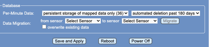

Two day ago, before the last failure I changed some settings to: store only mapped data and automated deletion after 180 days. This did not really release space on the storage but only the now remaining 192 MB is now sufficient for more days. And it didn't help as it crashed one day later again.
Is there is a problem with writing on that last left MB's? How can I free more space?

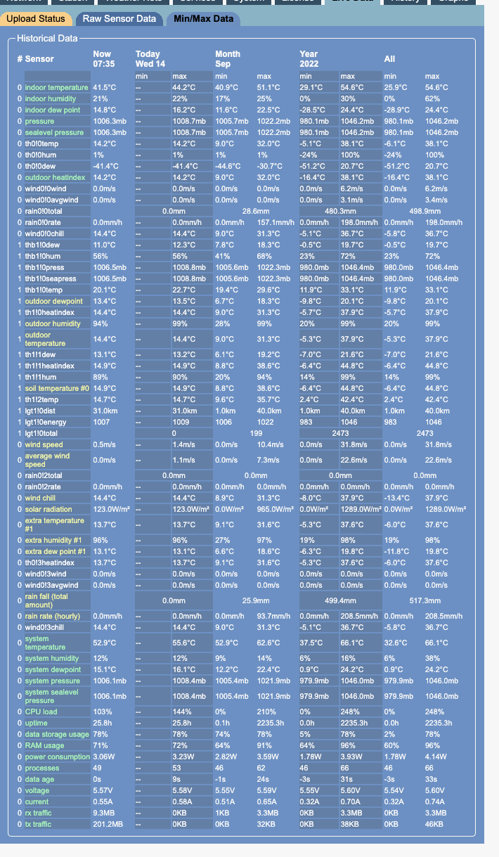

Schermafbeelding 2022-09-14 om 09.35.54.png (357.25 KiB) Viewed 2574 times
Schermafbeelding 2022-09-14 om 09.36.25.png (60.44 KiB) Viewed 2574 times
Schermafbeelding 2022-09-14 om 09.37.58.png (27.09 KiB) Viewed 2574 times

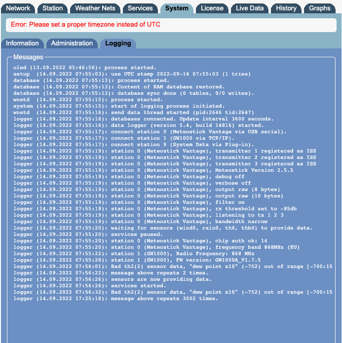

A screenshot of the latest log messages, but it hasn't crashed since last night. Except the usual warning for a humdity sensor that is not existing noting special as far as I can see. I don't know if it is possible to retrieve the log messages from before the reboot, but as I recall there was nothing special in it. If there is another crash, I will send the latest log message too.

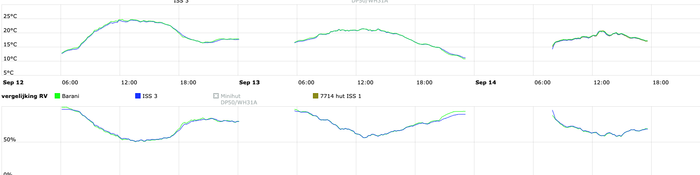

And the graphs from the last days are not ok. That's where I noticed first because I check them every day several times.

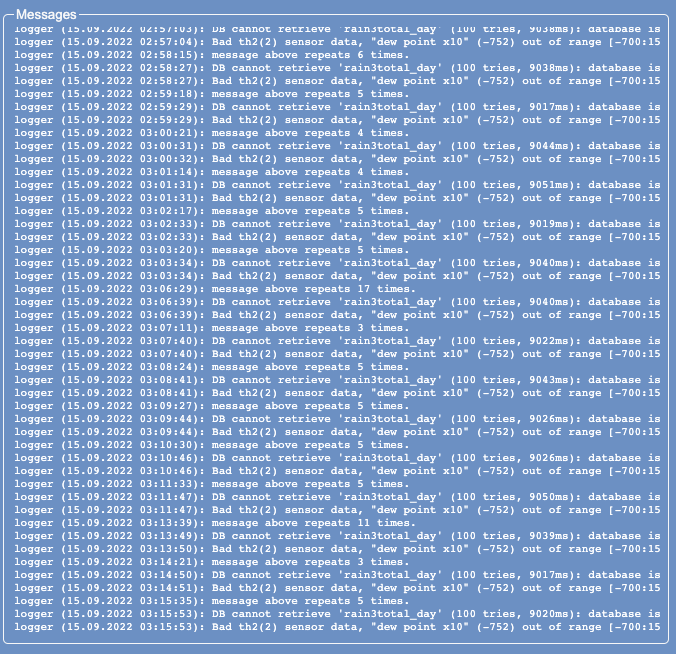

OK - the message log info (which disappears after a reboot as the log file with the same name is created at boot) would have been useful.
Next time it happens (fingers crossed that it won't :wink: ), take a copy of the log before you reboot the system.
It may give a hint why the logger stopped archiving ...
It also (rather rarely) occurs with my MB Pro and then it usually cannot write to a database table probably because it is locked and leaves a "--" in the minute recordings (History, minute data).
Also the station 9 data would be useful from the Min/May History - a system overload could be responsible for such a behaviour (wherever this overload may come from).
Looks that in your case it's not named station 9 but station 0 - the last 11 values in your min/max list

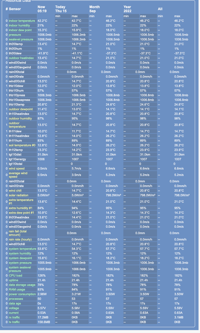

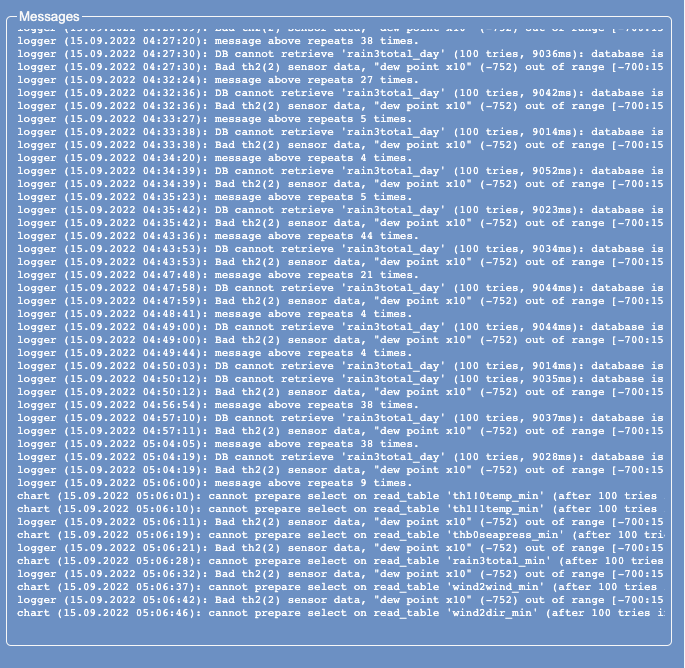

It happened again last night and now I cant make graphs either.
Long list of bad news:
Schermafbeelding 2022-09-15 om 07.10.27.png (269.72 KiB) Viewed 2521 times
Schermafbeelding 2022-09-15 om 07.11.10.png (266.39 KiB) Viewed 2521 times
Schermafbeelding 2022-09-15 om 07.11.39.png (263.63 KiB) Viewed 2521 times
The only good thing is that it keeps on uploading.
Schermafbeelding 2022-09-15 om 07.15.31.png (45.2 KiB) Viewed 2521 times
Raw data. The CPU overload is maybe caused by that I tried to retrieve data for the graphs. Usually it is far below 100 %.
Schermafbeelding 2022-09-15 om 07.19.50.png (266.91 KiB) Viewed 2521 times

The graph shows loss of signal each night. This looks very much like a battery problem, where in the absence of light the buffer battery does not provide enough juice.

I suppose that the cut text in the screenshot says "database is locked".
This usually occurs when another process works on the database and locks it.
Wondering what that would be ...
Do you have some regular imports running which may conflict with the data logger ?
Any other regular processes ("events") like backups ?
Also, your CPU load is quite high - when the CPU gets overloaded too much and too long, the system starts doing all types of weird things.
(but again this overload might come from the 100s/1000s of unsuccessful trials to write to or read from the locked database)
I must say that I had such "phenomena" (messages) too - but very rarely and a reboot would fix it. Maybe some bug which only shows in some special constellation...
That you cannot create/display graphs when the database is locked in just consequential. That's a collateral effect.
It would be good to know what other activities you are doing on the systems beyond the data logger archiving data and posting data to weather networks to see if it's a potential overload issue.
It looks as if some process had locked the database and didn't unlock it again. But which one and why ....
The reboot would remove this lock (until the missing unlock occurs again).
Maybe Boris can have a look into your system when you provide him the credentials for access ...
regarding your min/max history: (which may just be a 2nd-ary result of the locked database)
What is this th2(2) sensor of yours ? it seems to be calculated from your outdoor temperature/humidity sensor (or comes directly from your console - no idea how MB is connected to your Davis), and produces senseless values:
1% of RH outdoors and a dewpoint of -41.4°C .... - they don't look like correct values ...
what are your console values ? Do they match ?
Again, might just be some "dirt effect" caused by the locked database.
