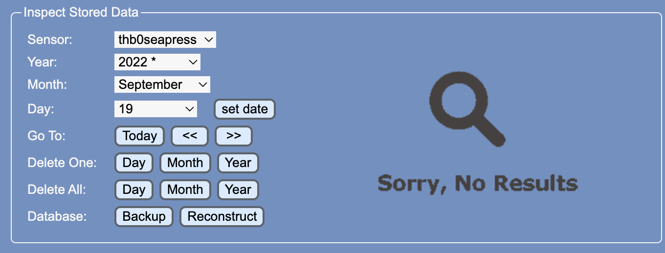

No, In history tab I don't see any data for thb0seapress.

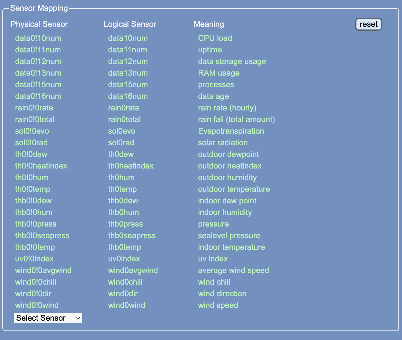

The sensor is mapped. See below:

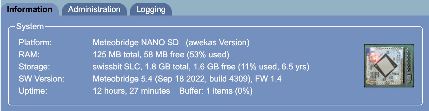

I have a NANO SD version:

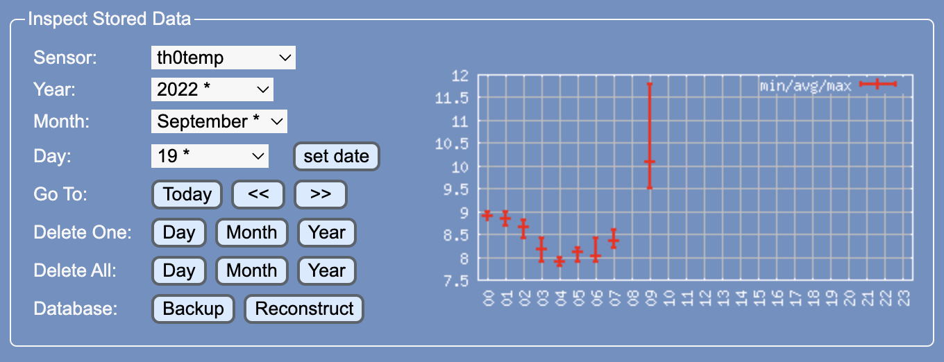

On the history tab I see a graph for th0temp, but not for thb0seapress

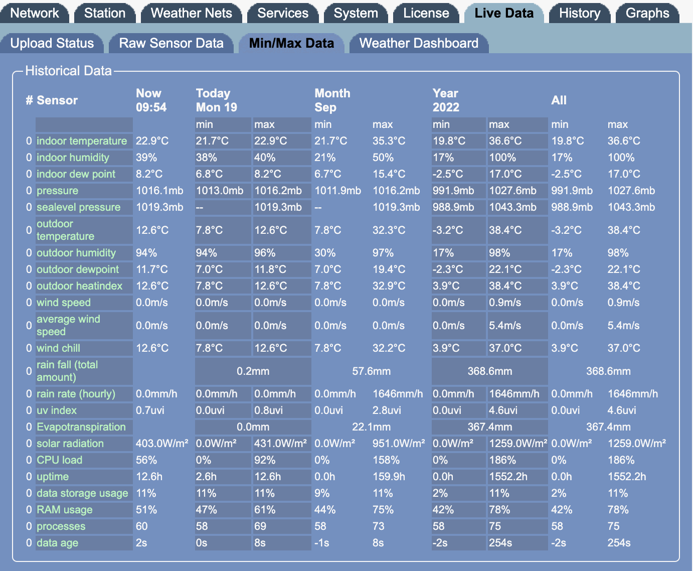

However in I see pressure in Live Data tab -> Min/Max Data. Here you see now sealevel pressure = 1019.3 mb.
In Today and Month columns the min value is empty. But in Year and All columns this filled. Because this used to work until an update in July, I assume this issue could be related to that release.
