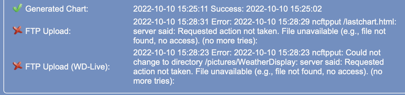

The Live Data tab gives these FTP errors.
Screenshot 2022-10-10 at 15.29.01.png (242.87 KiB) Viewed 820 times

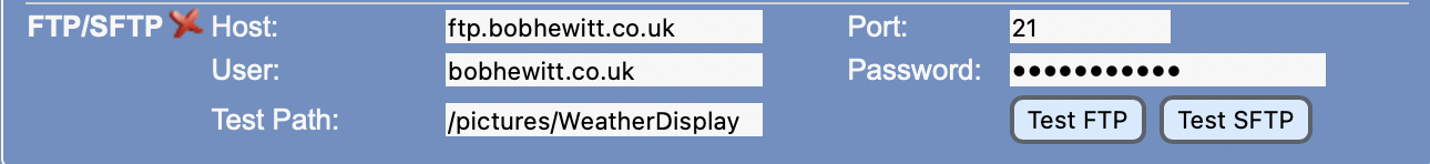

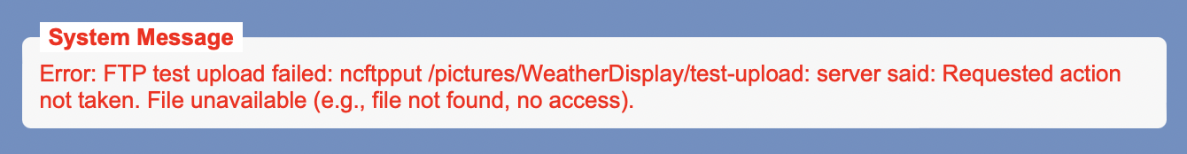

The Test-Upload also gives an error.
Test Uplaod Input.png (91.44 KiB) Viewed 820 times
Test Upload.png (104.09 KiB) Viewed 820 times

This fault has now been rectified. One.Com decided to alter the path to my site for ftp. My thanks to Francis for giving me a lead.
