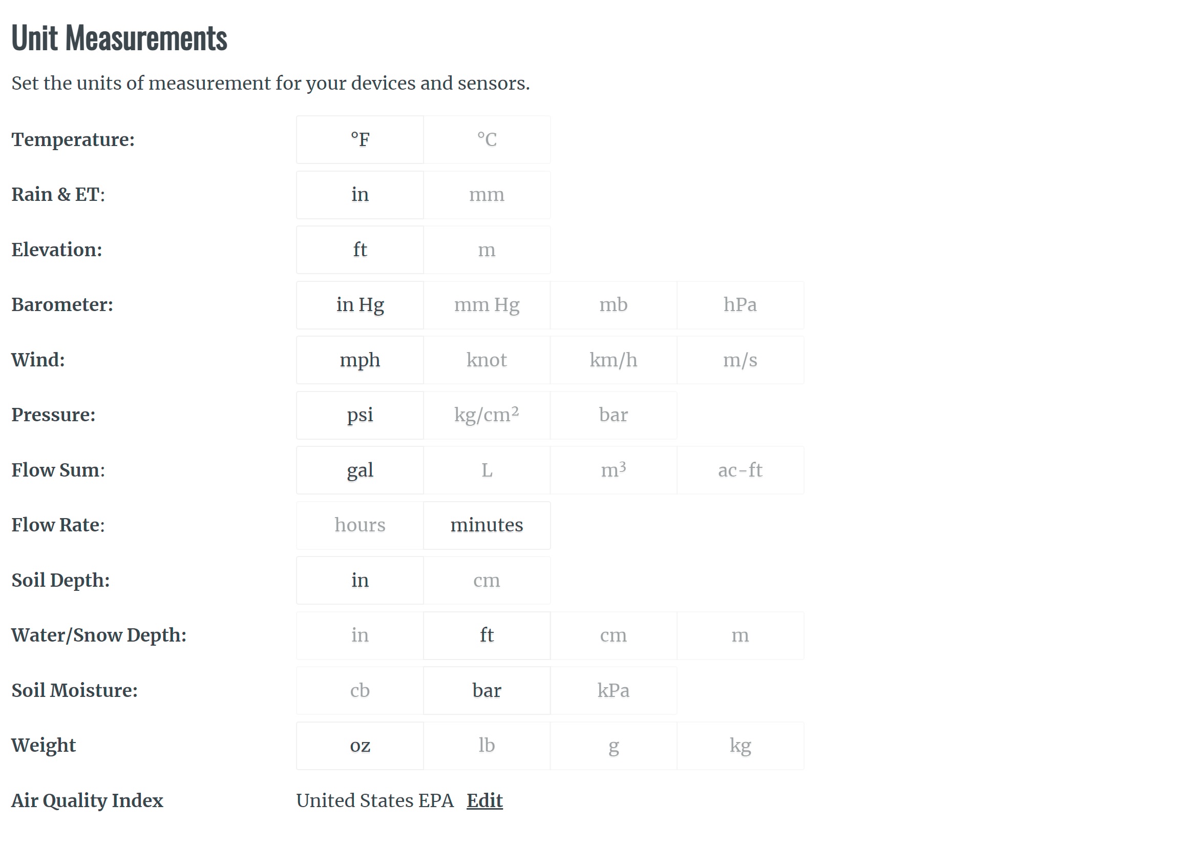

Re: Incorrect Rainfall Numbers on WeatherLink Bulletin Web Page
These are the settings for my station on WeatherLink.com
As for the Monthly readings, my console shows .87 inches. WeatherLink.com Bulletin shows .69 inches for the month.

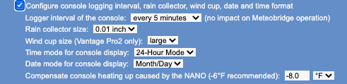

How much is it off per day? I added a conversion, when rain bucket tip is not set to 0.2 mm. Which is your setting?
It's off by a lot. =/ MB says I've had 1.55" of rain this month. WLL says I've had 0.83". For Nov, I have 4.84" from MB, and 2.57" for WLL. For Oct, MB says 1.56", WLL says 0.83".
Do I need to adjust somewhere else? Or re-set the spoon size?
Looking back, my post here: viewtopic.php?p=42246#p42246 doesn't seem to make sense anymore. Doing that math, it's extremely off now vs what it used to be.
Does the packet to Davis just want tips of the spoon rather than an actual accumulation amount? Is a conversion even needed, or is MB internally storing values in metric? Could the conversion be going the wrong way?
