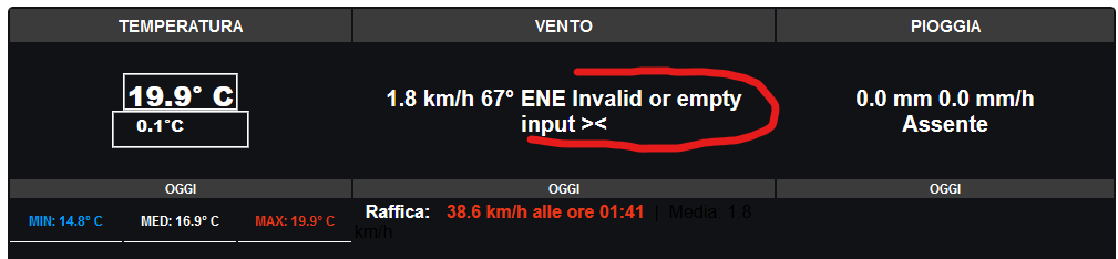

    break;
   default:
     $s= "Invalid or empty input >$direzione_del_vento<";
This will help to locate the problem. Between the >< the invalid data will be displayed. Or nothing if the field $direzione_del_vento is empty.
Also when testing, set error messages on. Change the first line into
<?php  ini_set('display_errors', 'On');   error_reporting(E_ALL);

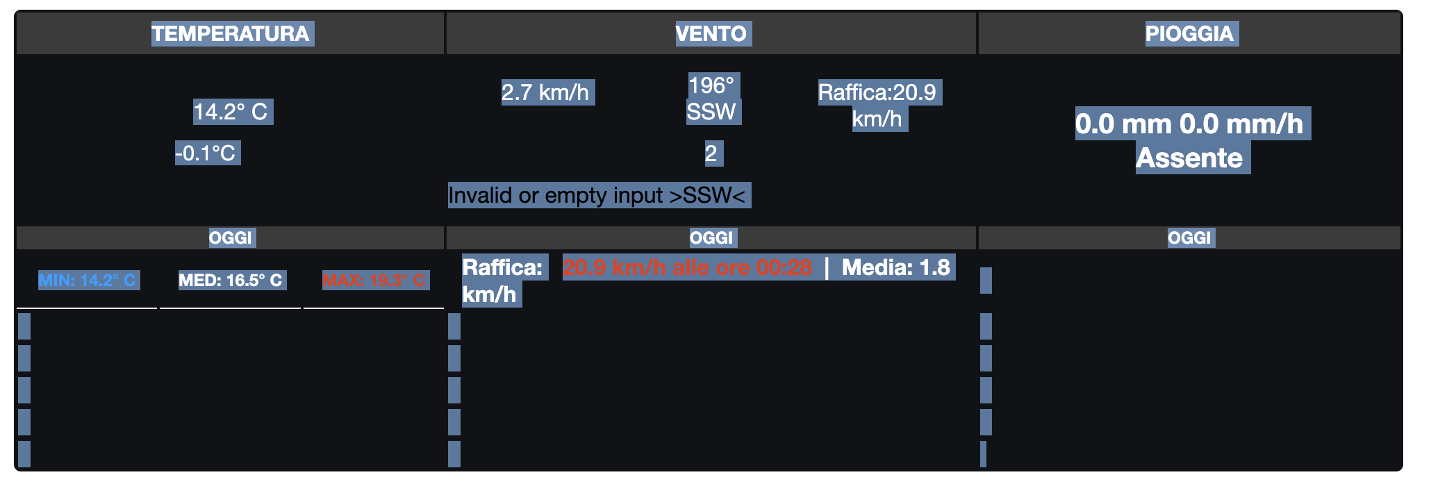

So, now by inserting the code from indicated, on the page on which I put links, to the previous post. The wind direction is written, but what I wanted to do was to make the name of the type of wind appear, as you can see in the php code the various names of the wind, mistral, tramontana, sirocco .... the switch code should according to to the wind direction, write the name of the wind itself.
I hope I explained myself better.
Re: PHP Enter the name of the winds according to the tag [wind0dir-act=endir:--]
It seems the text is displayed but it is in black.
So it is not visible on the black background.
Schermafbeelding 2022-12-17 om 22.16.54.png (123.7 KiB) Viewed 3066 times

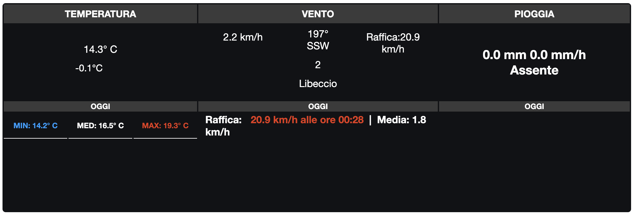

Yes yes I know it's hard to see each other on a black background, I have to change the color.
But what I want to get written, is not SW, W, WNW, S, SW, E....etc....
I would like him to write the name of the wind: Maestrale, Ponente, Tramontana, Scirocco, Libeccio.
If you look at the php switch code, case based:
switch ($direzione_del_vento)
  case "WNW":
  case "NW":
  case "NNW":
    $s = "Maestrale"; Must write and appear this
    break;
  case "N":
    $s = "Tramontana"; Must write and appear this
    break;
I copied your html from a browser, inserted the PHP code from your post and it ran correctly.
=> attached screenshot
Please make a zip of the template file your Meteobridge is reading and processing.
Attach that file to your next post
I can test that with my MB-nano and find the type or whatever is happening.

I just tried your changes by renaming the Dashboard1.php file to Dashboard1.txt http://www.ombarcellonapg.com/saratoga/dashboard1.txt
only now on the page http://www.ombarcellonapg.com/saratoga/dashboard2.php , the dashboard.php file remains empty after I reload the template, is this normal? Do I need to make any changes?
can't see anything anymore why? Have I reloaded the model?
I also enclose the changes to the meteobridge below.
