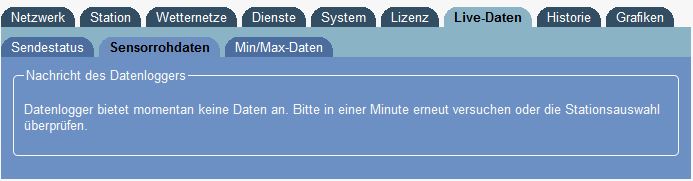

After updating to v5.5 the MB Pro does not work anymore.
A rollback to an older version does not help.
The USB flash memory has been exchanged 2 months ago, so this should not be the problem.
