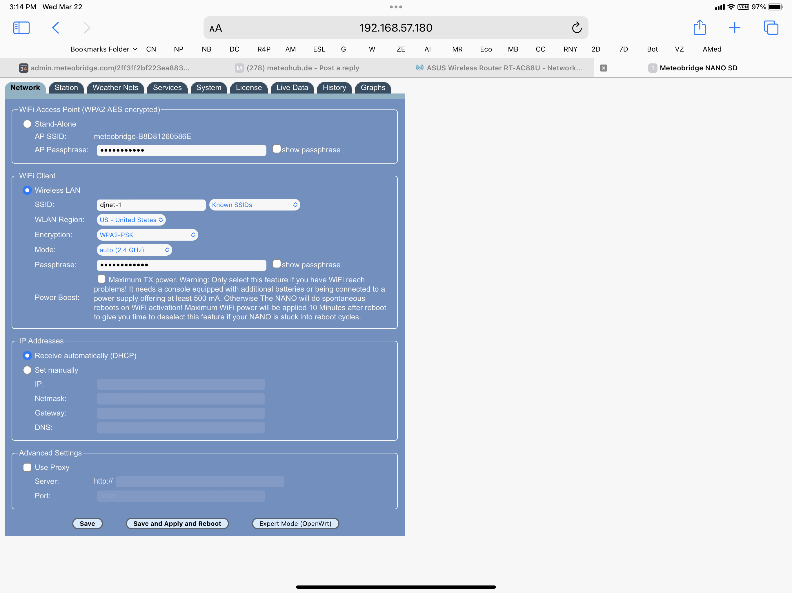

I took a screenshot of the Nano network tab - do you see anything here I should change? Thanks
Re: Nano dropping, reconnecting continuously from network
What does Meteobridge Log-File tell?
