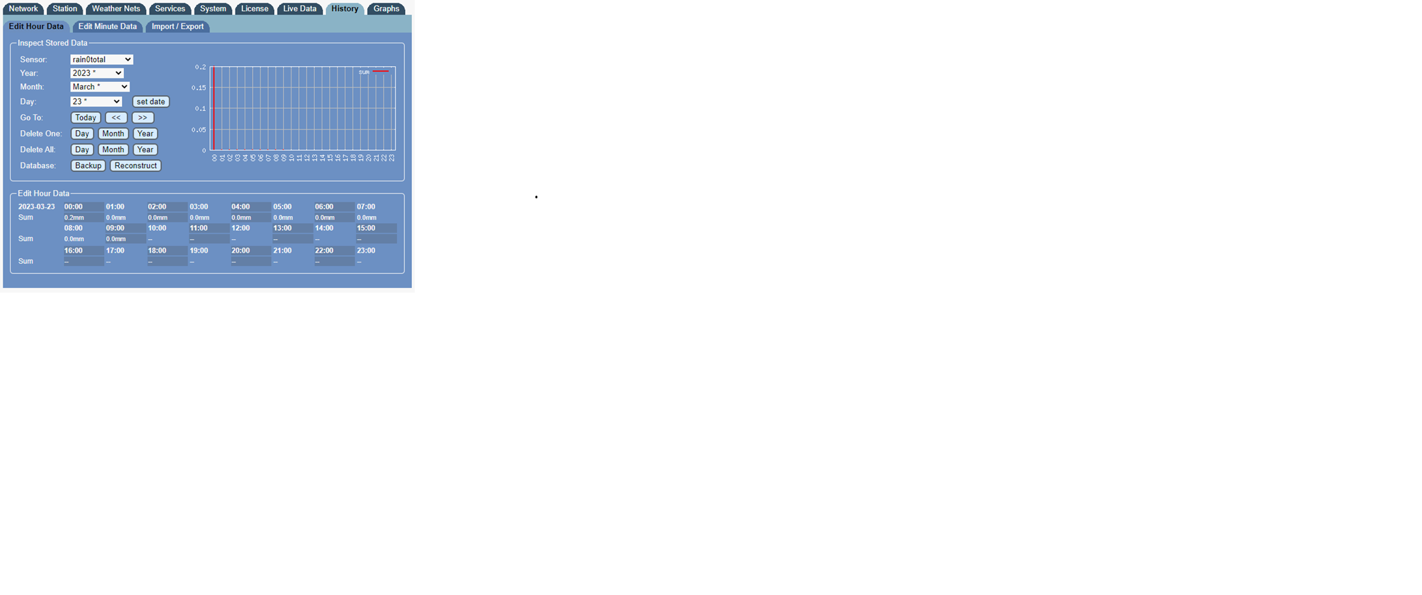

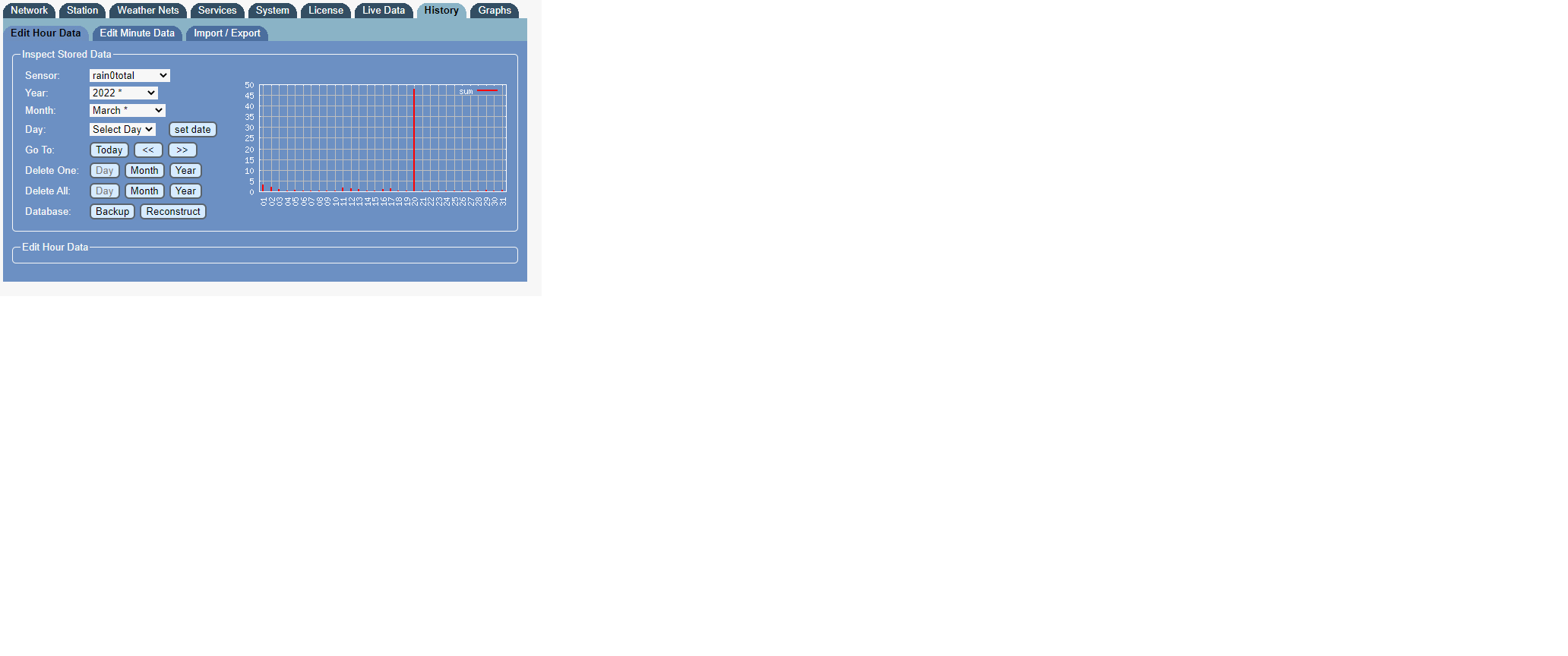

What does the MB rain history look like for March 22?

Below is the rain total for March 23 2022 there was no rain. was that what you were asking for?
Today 2022.png (43.88 KiB) Viewed 932 times

Here is March 2022 as well.
Mark
March 2022.png (33.94 KiB) Viewed 932 times
