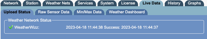

Re: Twitter **solved**
No, please look here. Twitter should be mentioned in your case:
Bildschirm­foto 2023-04-18 um 11.45.00.png (28.92 KiB) Viewed 2276 times
Post by saroyan17 »
No Twitter does not appear at this location!
