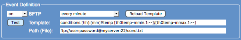

I have my FTP details saved in the Service Settings on my Meteobridge, uploading various files to my remote server.
I would also like to keep my data locally on my Synology NAS and wondered whether it is possible to also send files to a second server somehow?
Simon
Re: FTP to second server?
yes, example:
