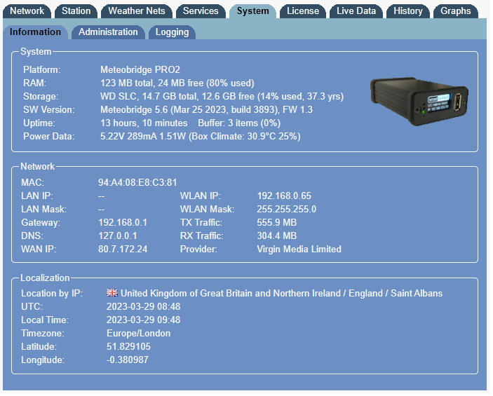

Meteobridge Pro 2 System Information Page
sys info.png (53.27 KiB) Viewed 702 times
