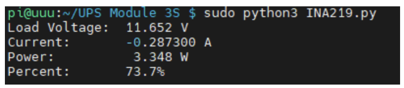

May be a bit off topic but I am looking to Run My Meteobridge PRO 2 from a Waveshare UPS 3S so that it continues to collect data in the event of power failure. I noticed that the unit has an I2C header and they provide some example Python scripts for a Raspberry Pi to monitor it. I currently have a Temp/Humidity sensor plugged in to the I2C port to get outside of the pro 2 unit data and would want to keep as well.
Two questions come from this I suppose.
1) As I2C is a Bus technology can Meteobridge take input from multiple devices on the I2C Bus provided?
2) Maybe a question for Boris if the first question has an answer of yes, is it possible that the data provided by the UPS (as below) be captured and made available in Meteobridge as any other sensor data?
Screenshot 2023-04-15 at 15.28.32.png (53.21 KiB) Viewed 912 times
The product details are in the following web sits as well as access to the python code
https://www.waveshare.com/wiki/UPS_Module_3S
I suspect it is a very specific requirement but I thought I would ask if it was possible to start with.
Thanks for any pointers or suggestions.

The I2C address of your device needs to be separate from the I2C devices inside the Meteobridge. Meteobridge already has devices on addresses 0x3c, 0x41, 0x45 and 0x76. As the INA219 has an adjustable address in the range from 0x40 to 0x4f it depends on how your device is configured (determined by the PCB, cannot be modified by SW). Meteobridge uses INA220 internally for measuring voltage, current and watts, so adapting the read out code to INA219 might be easy to do.
When you connect the device to your PRO2 and give me remote access, I can give adaption a try.

I inspected the python code and unfortunately the module uses address 0x41.
# Create an INA219 instance.
ina219 = INA219(addr=0x41)
So we are out of luck :(
