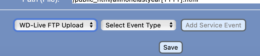

If you create a WD-Live FTP Upload event in events with the type Periodical and fill in the destination path info and the frequency that should do it.

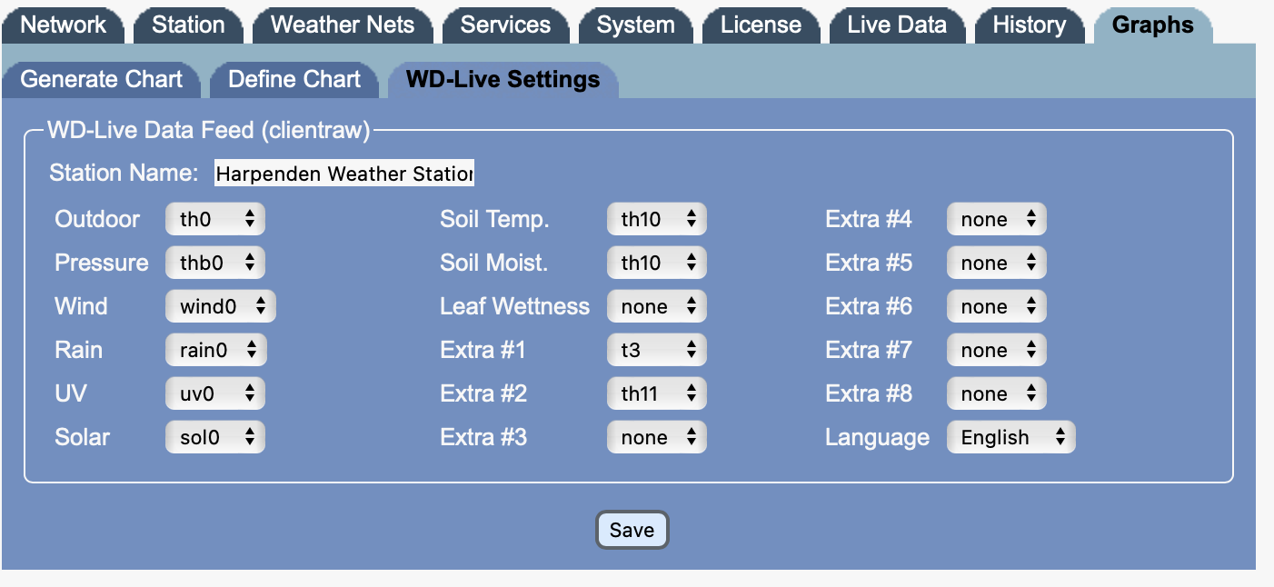

Hi Again,
You also need to set your Station name and the data you want to send in the clientraw file this can be don't in the GUI and the defaults should be fine or were for me.
Mark.

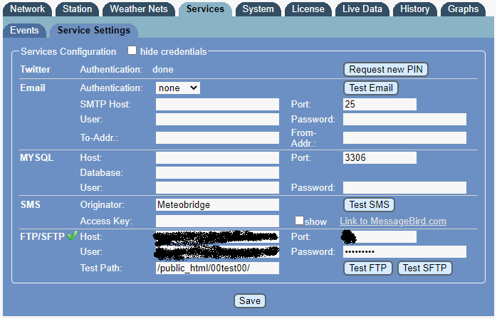

Just entering a / in the [Events] Path (file) will be reliant on FTP/SFTP Host configuration along with obviously the correct User/Password & Port. On the Service Settings page what happens when you do a [Test FTP]?

The FTP in Service is set up with the full path to the root and a ftp test puts a file in the root of my website sp I assume that is correct.

Just thought I would share my Upload event settings it may help you sort the issue. Some web hosting sites have a specific directory you need to store the files in which is not the root directory. For me it is /public_html. I put the data in a "Live" sub directory to keep it separate from the rest of the website but that is just me. My setup looks like the information below and the path I configure in MB for the FTP WDL event is /public_html/Live/ and that works for me. If I just use the root "/" the transfer is successful but the file is in the wrong place for the website to use correctly as it is not in the websites base directory hope that makes sense.
WDL Event.png (3.72 KiB) Viewed 2013 times
As a test you could also set the FTP/FTPS service and fill in the test directory and test it to make sure the test-upload file is placed in the correct place and the path that works and puts the file in the correct place, will be the path you need to put in on the FTP WDL event.

Well after a lot of head scratching I finally managed to get clientraw.txt to my website. My thanks to MGS for giving me the idea.
In Services configuration I had a test path of /customers/1/1/e/bobhewitt.co.uk/httpd.www/
Why this is so complicated I don't know but my Host One.Com changed it this this after the PHP 8.1 upgrade.
So, in Event Definition I created a FTP WDL with just a / in Path (folder) - this didn't work but by adding /customers/1/1/e/bobhewitt.co.uk/httpd.www/ it worked.
Thanks all for your help.
