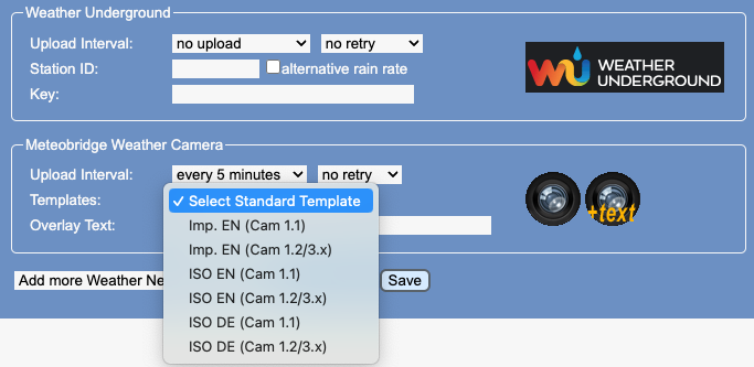

Thanks. That was basically my question. So now will create a Service - Camera FTP Upload. Not sure about the path as to whether it is a MB path or a path on my website. Also you mention date/text so is there a template for this.
Re: Webcam Query
G4MHJ wrote: Wed Apr 26, 2023 9:20 am Thanks. That was basically my question. So now will create a Service - Camera FTP Upload. Not sure about the path as to whether it is a MB path or a path on my website. Also you mention date/text so is there a template for this.
The path resp. filename on the target server is needed here.
You can also define a weather network event, that pushes the image to Meteobridge server and there weather data can be annotated by the help of a predefined template or one defined by yourself. Final image will then be available by a special URL.
Bildschirm­foto 2023-04-26 um 12.22.36.png (80.16 KiB) Viewed 1205 times
