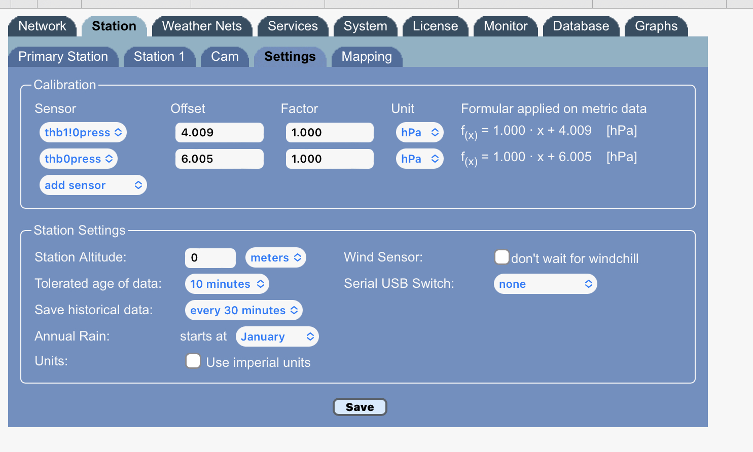

Hi all my meteobridge pro red is showing a different barometer reading then my Davis console which is showing the correct pressure
Is there any way that I can adjust this
I have tried this in system settings
Many thanks for your help

Is the MBPro red sensor connected via RF/USB/IP?
Do you know what the Davis console pressure type is and what the Station Elevation is set to?
What is the Elevation of the station? The MBPro is showing 0 meters?
Calibration wise you are on the right page but first you need to confirm what the Davis console pressure actually relates to, Console Reading or Sealevel Barometer. I would reset the calibration numbers to default and check from the bottom up before introducing any Cal values.
Also note there is a thb0seapress

Re: Meteobridge Red pro barometer readings out
Many thanks Mattk
Weather Networks normally ask for sealevel pressure. Therefore you should adjust thbXpress and thbXseapress.

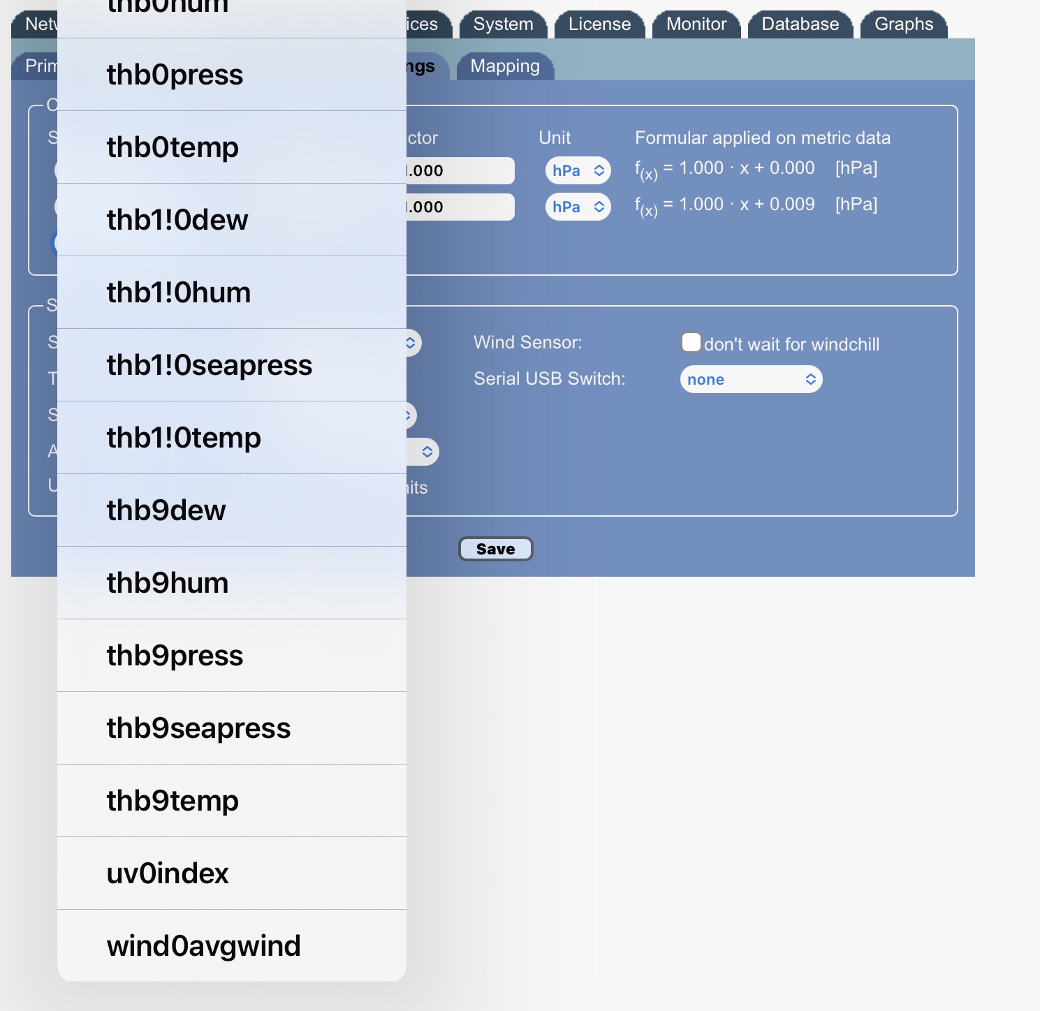

Hi many thanks for your reply
I don’t have the option of thbXpress and thbXseapress
So which one do I adjust picture below
Many thanks
Many thanks
There should be, that list is very different to what I see?
Is that list what you see when you click [add sensor v], the drop down under the 2 sensors in a previous screen shot?
