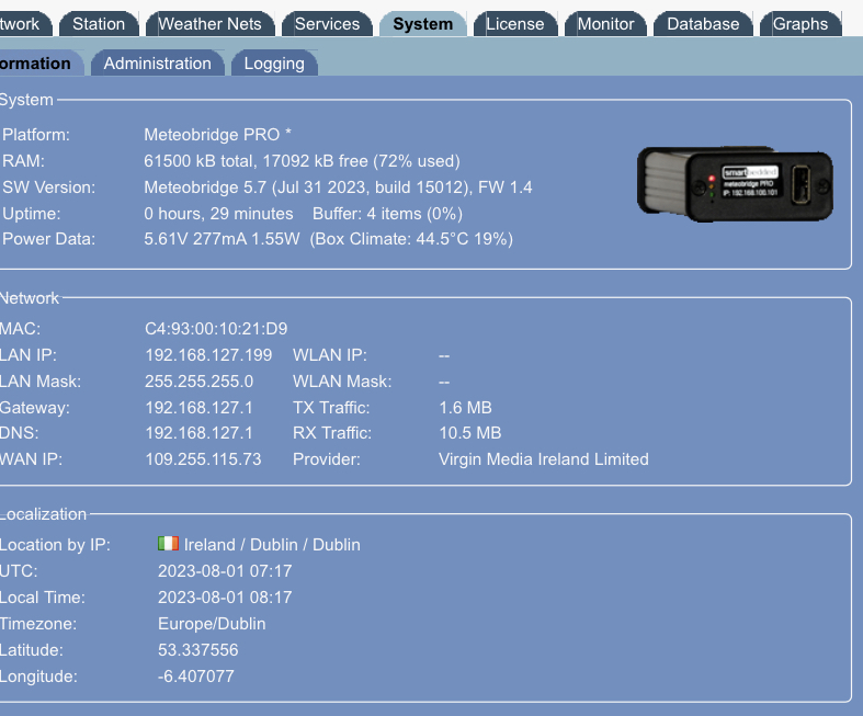

Anyone elses pro red showing as a black Meteobridge pro and not showing all the data since last update Image

I’ve dropped the framework back and it the same still shows a black Meteobridge
I’ve a second Meteobridge pro and it updated perfectly and the picture is a red Meteobridge any ideas

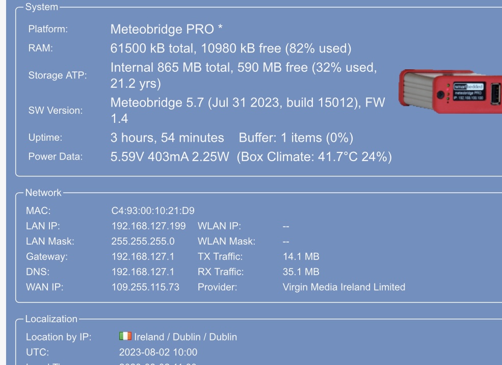

I unplugged it overnight and it’s back this morning as a Meteobridge red 😀🤫
A bit of a mystery

When it shows up as black and does not indicate any internal storage on "System - Info" tab this indicates the the internal USB hub did fail. Glad to hear that a power cycle fixed it.
