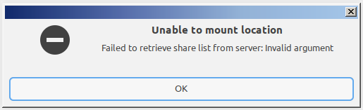

I am trying to access the MBPRO2 via SMB but gives an error ( Failed to retrieve share list from server: Invalid argument )
SMB works fine with the NANO.

Connected to what OS? What are your SMB settings?

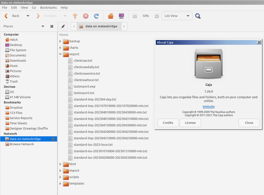

Using Ubuntu Mate 22.04 LTS, Caja is the file viewer. The attached picture shows the NANO working with Caja.
As far as SMB settings go, I will have to research where to find them. Does the MBPRO2 require special SMB settings?

Re: MBPRO2 SMB
SMB settings under MBPro System>Security> right hand side box of SMB password
In Windows simply use \\ip.address.of.MB\

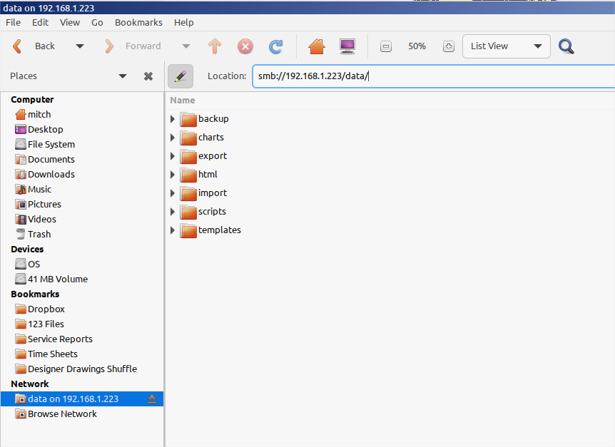

I figured it out. With the NANO I only have click the name meteobridge and it would work just fine.
The MBPRO2 I have to manually type the address in. Without data at the end it fails. With data at the end it works.

Can I restore the database from the nano to the mbpro2 with out issue?
Thank you.
- Screenshot at 2023-08-05 22-32-03.png (68.39 KiB) Viewed 3034 times
Re: MBPRO2 SMB
Why don't you just try ?Mitch56338 wrote: Sun Aug 06, 2023 5:48 am Can I restore the database from the nano to the mbpro2 with out issue?
make a backup of your NANO DB on a USB device
restore it on the MB Pro2
(you may need to move over the configuration file, too
remember, when you have both running in parallel, there will be only one share called METEOBRDIGE,
the other one you will have to address with \\IP-Address\data

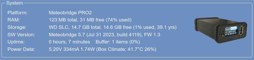

I have an additional question. Which pressure is the correct pressure thb0seapress or thb9seapress? thb9seapress is close to the VP2 console pressure.
- Screenshot at 2023-08-06 16-16-36.png (152.2 KiB) Viewed 3014 times
Re: MBPRO2 SMB
The formula used by MB is not exactly the same as Davis so there will be a minimal difference relative to the other facts like temp/alt etc
Have you checked the altitude settings? How does the raw pressure data compare?

Both pressures are from the MBPRO2 which is confusing. Which one is the raw pressure?
thb9seapress matches KSTC the closest METAR station that reports sea level pressure.
Re: MBPRO2 SMB
MB station/raw pressure is thb0press with thb0seapress derived from this, a VP2 has a console reading pressure set using the station elevation and Sea-level Barometer reading.
Re: MBPRO2 SMB
thb9seapressure looks to me like the pressure from the system (System #9) insinuating that the MB Pro2 has a pressure reading chip on its mainboard.
thb0seapressure is the pressure reading provided by the primary station (unless you did some sensor mapping, but with what ? you have only one station connected). Both, your Davis and the MB pro may use different methods of calculating the resulting SLP (sea level pressure) and therefore differences are possible. Even their local pressure reading may differ as nobody gauged them against a thrid reference gauge.
Up to you what you want to do
a) leave it as it is
b) correct either one of them to match the other in the Station --> Settings --> calibration section
c) use a close (and at the same altitude = located on the same isobar as your console location) airport METAR reading as a gauge and match both to that reading (again in the Station --> Settings --> calibration section)
Re: MBPRO2 SMB
thb9 is the internal pressure sensor of the MB PRO2. When you operate primary station by reading the RF data from your Davis sensors then thb0 will be equal to thb9 as Meteobridge does not get pressure data from the Davis sensors (pressure is measured in the Davis console and not sent out via RF). When you have a weather station connected as primary station that provides pressure data, then thb0 will reflect this data.
