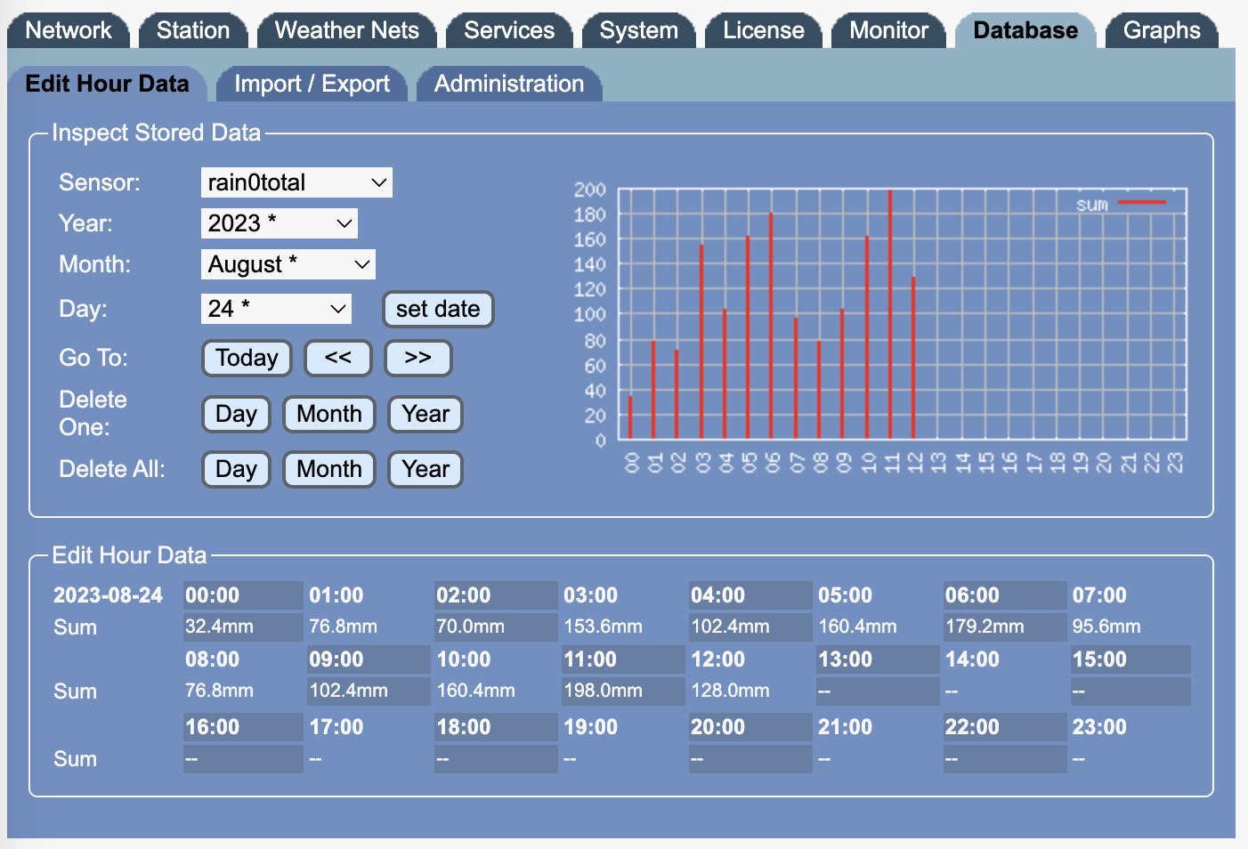

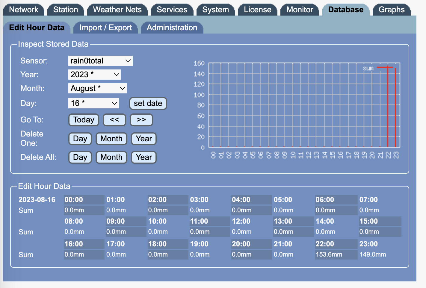

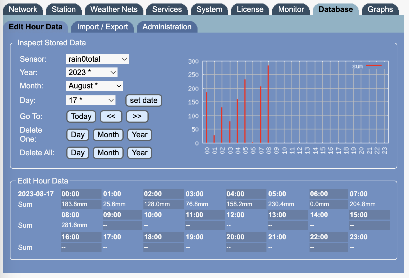

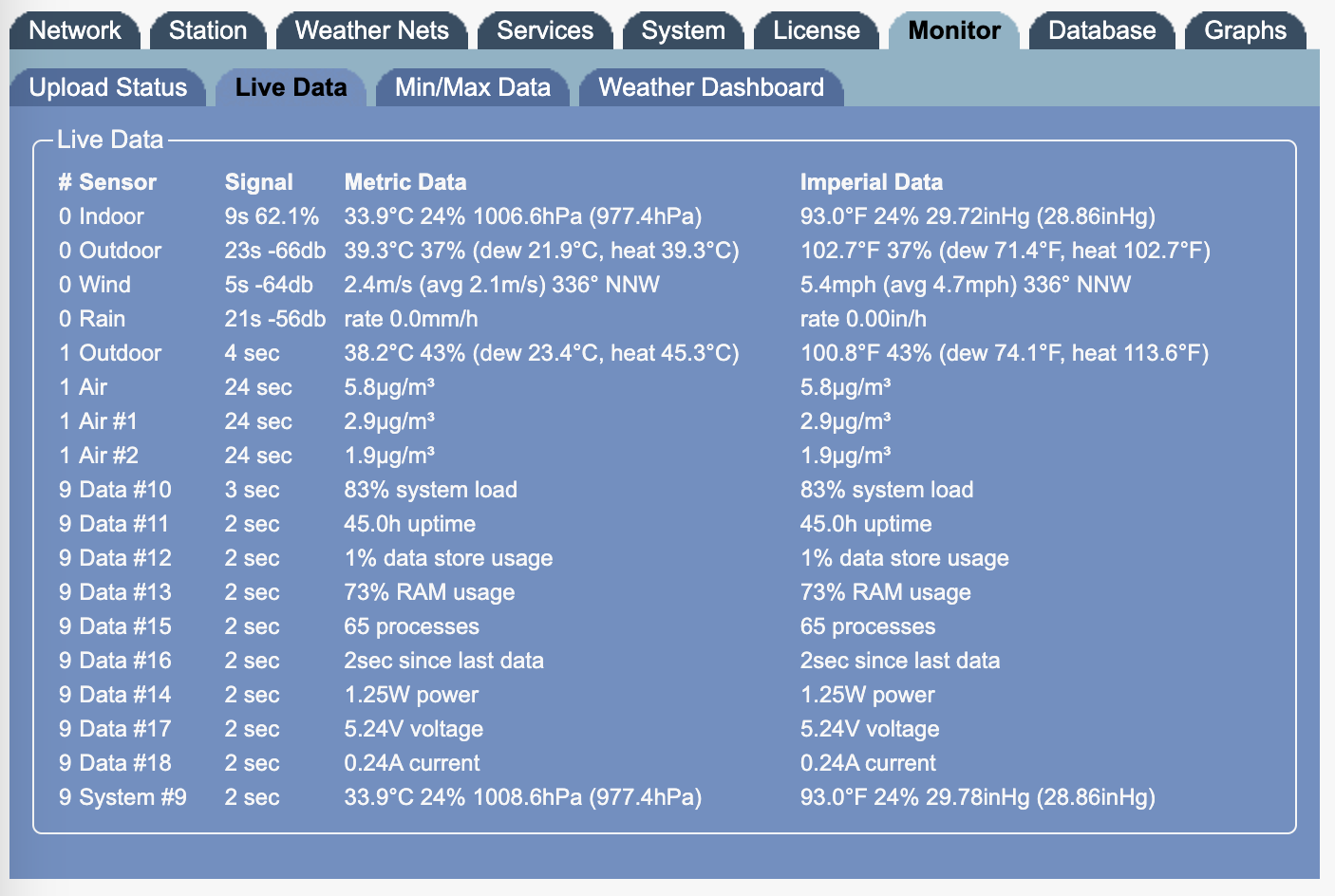

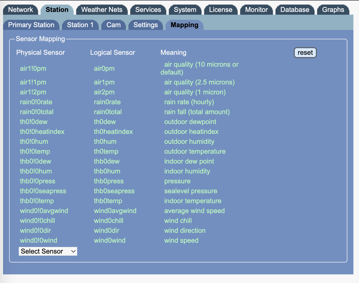

I would really appreciate any insights or suggestions to fix this. If the forum admin or software developer needs direct access, I am willing to provide SSH access to my device to help with the troubleshooting process. Also, for reference, I have attached three screenshots showcasing the exaggerated rain totals that Meteobridge is displaying.

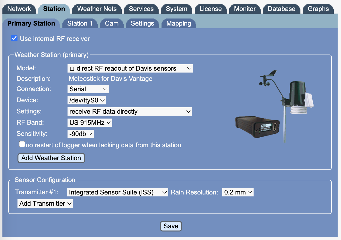

RF on the Meteobridge PRO2 and rtldavis on the Raspberry Pi 4

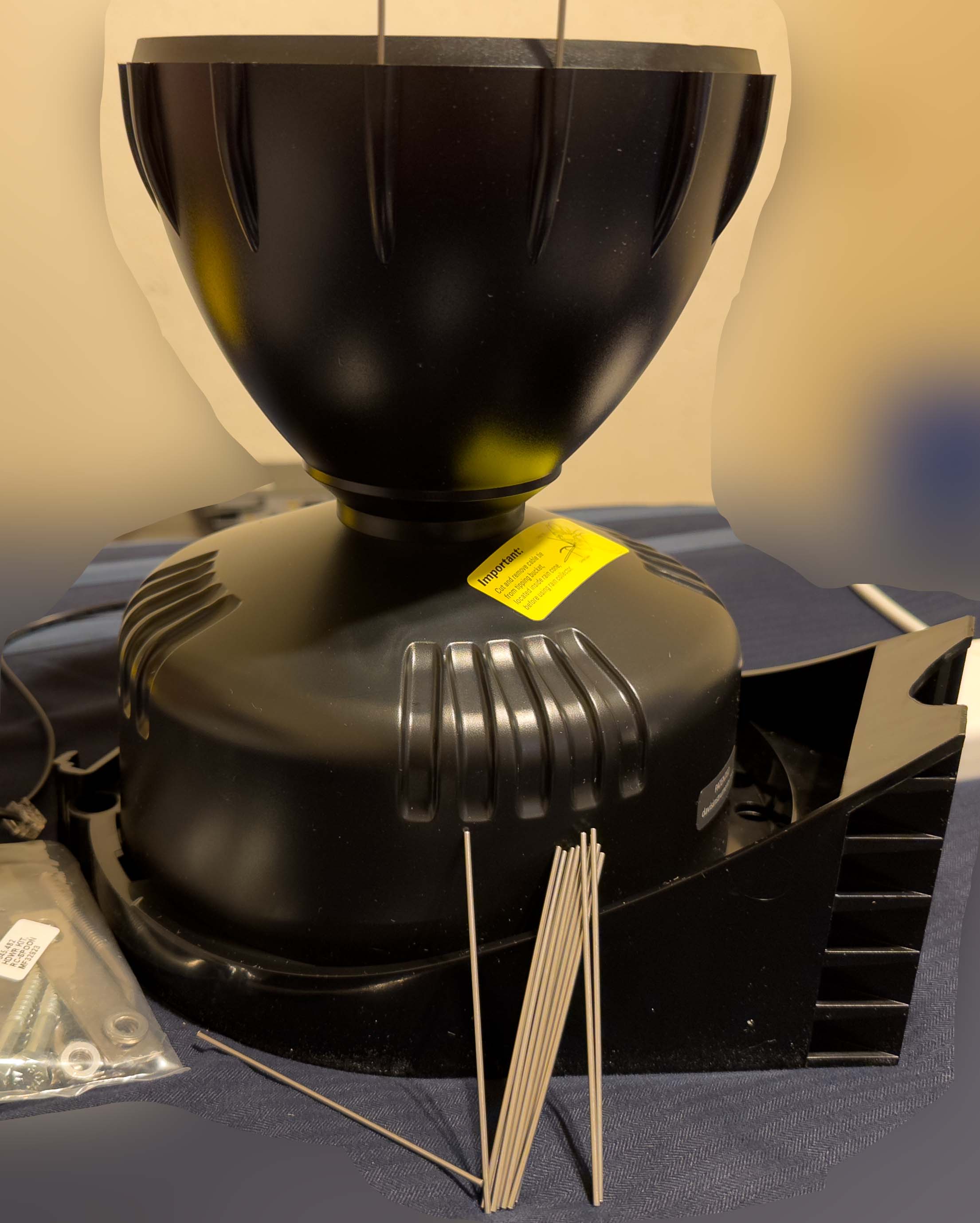

I bought the Davis Instruments 6466 Davis Aerocone® Rain Collector and watched some videos on YouTube to see how to install the rain collector. The person on the video mentioned some instructions to clear the data that the ISS had gathered:
Clear Data Collected During Testing and Installation
Now that the ISS is mounted outside, any data that was collected in the Vantage Pro2 console during testing and mounting can be cleared.
1. On the console, press the WIND so that graph icon appears adjacent to the wind data on the display. Confirm that wind speed is displayed on the compass rose.
2. Press and release 2ND, then press and hold CLEAR for at least six seconds and until you see “CLEARING NOW” in the console ticker display.
I do not own a "Davis Instruments Vantage Pro2 Console/Receiver" because it stopped working long ago. I bought a "Davis Instruments 6100 WeatherLink Live" to replace the console, thinking it would be a better option (oh boy! I still regret this).
The problem is that I think neither the Meteobridge Pro2, The Raspberry Pi4 running using the rtldavis driver, nor the WeatherLink 6100 can clear data collected on the station because they only receive information; they do not send anything to the ISS (I may be wrong here assuming this). Neither the Weatherlink nor the Raspberry Pi get incorrect precipitation values, and the Meteobridge Pro2 is the only device getting unrealistic precipitation values.
If I cannot borrow a Vantage Pro2 console in my city to clear the data, the best way would be to call Ambient Weather and tell them I have a faulty unit, correct?.

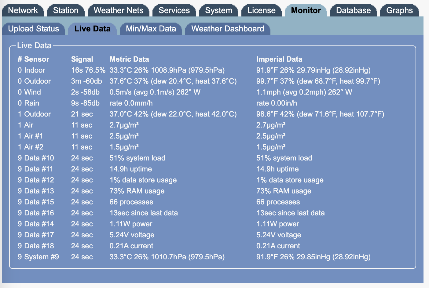

New rain sensor
New rain sensor
Rain total incorrect information

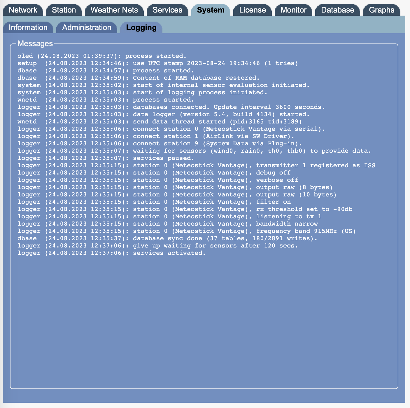

Meteobridge logging
Meteobridge logging
Sensor mapping
Sensor mapping
Unrealistic data stored

I recently reached out to the Ambient Weather support team for guidance. Their recommendation was:
For RF data incoming at approximately -50db, it's advisable to adjust the threshold to -70db rather than -90db to stabilize the received data.
Following their advice, I modified the setting to -70db and cleared all rainTotal data from the Meteobridge before resuming data uploads to their network.
I'll be closely monitoring the rainTotal weather data uploaded to their platform to see if this resolves the issue.
