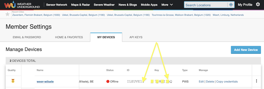

Some weeks ago there was another run of updates at WU.
One of them is the use of WU_station_Key replacing the user-password in the uploads.
You have to check if your settings in your Meteobridge contain the Key
You find the key in your WU-profile -> Member settings -> My Devices.
After you start using the Station_Key in your Meteobridge it can take an hour or more before your station appears on-line at WU again.
See attached screenshot.

Hi Wim,
That did it. Thanks very much. I had no idea what was going on.
