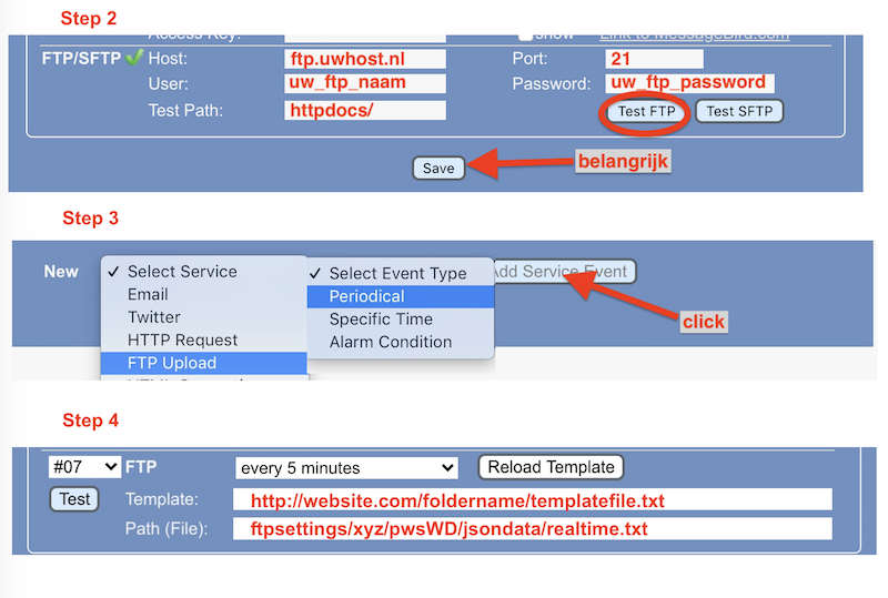

Before flashing your SD card, you could post the problem with the URL to your PWS_Dashboard site, maybe als a screenshot of your MB FTP upload settings

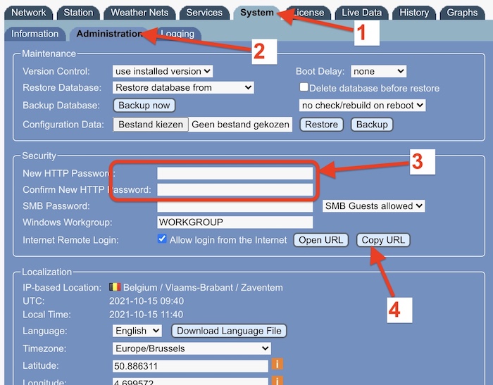

And if needed, a Meteobridge supports remote support you can switch on to give remote access to your device. Either for the developer of Meteobridge if it is a Metebridge problem. Or to me if you can not get the upload working correctly.

Looks like the screenshots are not from the base version of the WeatherBridge I have but the PRO or NANO version. Does it work with the standard version: https://ambientweather.com/awn-weatherbridge
I installed PWS_Dashboard on mt web server and tried to setup the FTP connection and event according to the above screenshots and in the PWS_Dashboard setup. I have a page now at http://wassmer.org/pwsWD/index.php?them ... k&units=us but it does not seem to receive data
OK - it receives data - now I need to adjust the template to get my PurpleAir sensor on and delete the not-used and not-needed parts.
They are all similar, but some has more features, especially more memory
