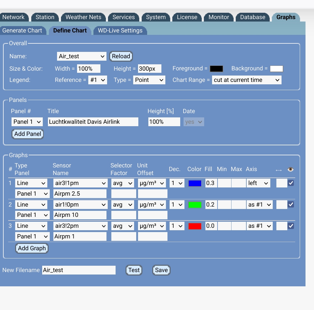

In my log of the Nano SD I get a ton of messages indicating I have some unused definitions in my made metacharts
Some fields I left blank, are all mandatory?
My metacharts are working fine
Unused definitions in metachart. **solved**

- IMG_20240110_084405.jpg (332.97 KiB) Viewed 53190 times
- Screenshot_2024-01-10-08-41-57-50_3aea4af51f236e4932235fdada7d1643.jpg (269.03 KiB) Viewed 53190 times

When you give me a remote login, I can have a look.
Or you send my the chart definitions (chart files are found on SMB share in folder /data/templates)

Re: Unused definitions in metachart
I'll send you my chart definitions
Maybe there is something wrong with them
Edit:
I redefined all the metacharts which caused the unused definition errors but after redefining them and with a different name I still get the same messages in the log
Edit:
Can you give me (info(at)meteobridge.com) remote access to your system ? I tried with your definitions on my Meteobridge and no errors where shown.
I'll sent the credentials
The unused definitions error is caused by cumulusMX which I have installed on a raspberry pi
I used cumulusMX to download the graphs and then upload them to my webserver
I now directly download the graphs by iframe to my website
Since I have deleted the cumulusMX downloads of the graphs the error of unused definitions have disappeared
Error is now solved
Error is now solved
