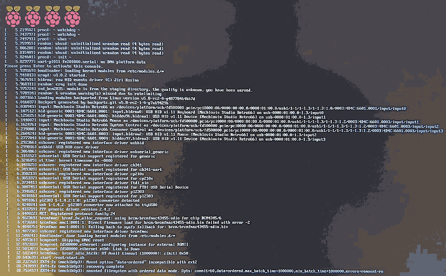

4) I disconnected the ethernet cable, restarted the RPi and I see this on the screen instead...
Those last three lines didn't come up on the initial boot and there's more that should take place after that before the software is fully functional so as of now, this system is non-functional. To make that easier to read, they are.
EXT4-fs (mmcblk0p3): Mount option "data=ordered" incompatible with ext2
EXT4-fs (mmcblk0p3): recovery complete
EXT4-fs (mmcblk0p3): mounted filesystem with ordered data mode. Opts: commit=60,data=ordered,max_batch_time=1000000,min_batch_time=1000000,errors=remount-ro
I'm not sure this is the problem, only that this is where the messages stop. Has anyone encountered this and can they help me figure out how to correct it?
I can access the command line by hitting enter at this point, so there's some functionality.

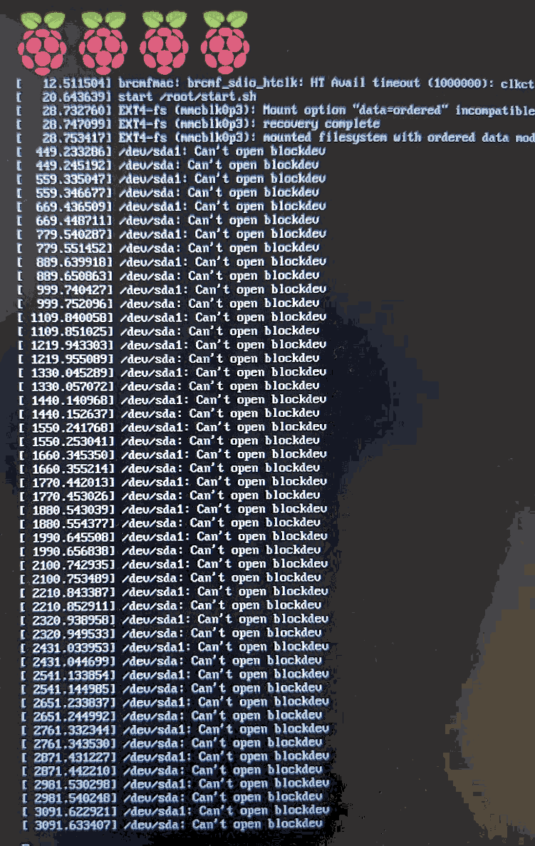

I hadn't been watching what the screen was doing as the unit is another room, but when I came the following messages are repeated on screen. A possible clue perhaps?
/dev/sda1: Can't open blockdev
/dev/sda: Can't open blockdev
