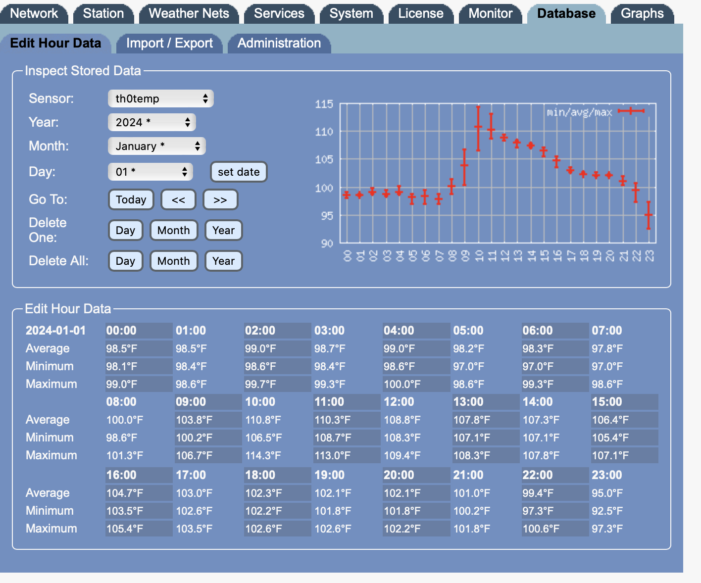

Hello All,
Building out my replacement Meteobridge and tried to import data via the IMPORT FILE in 'Meteotemplate' format. My Meteotemplate file is in Imperial and my Meteobridge has the option under Station>Settings>USE IMPERIAL UNITS checked. Still when I import data, Meteobridge is treating the data is if it is in metric and not as it is in imperial units. Changing the USE IMPERIAL UNITS is not an option as the source data is still in imperial so it end up still being incorrect on import.
Is there a way to get the import to work with imperial or am I going to need to convert the units on the import to metric first.

As imported:
