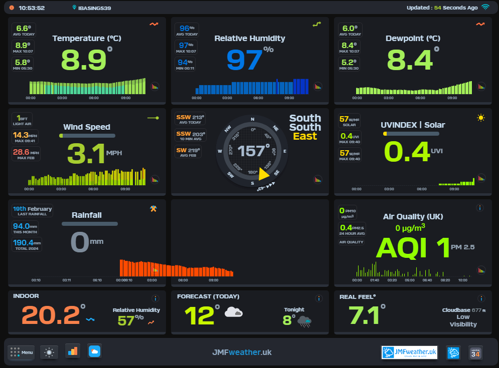

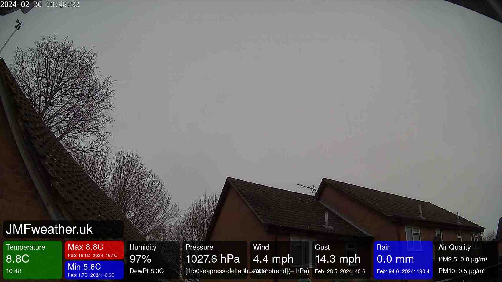

Symptoms of this are showing up in my Webcam overlay
and in my Weather34 display where it's killing the Barometer section
Screenshot 2024-02-20 105358.png (150.81 KiB) Viewed 2091 times

In this case I was doing nothing non-standard. The error shown in the Webcam was using the standard webcam overlay processing provided as one of the default weather net services.
-resize 1706x960 -fill green -draw "fill-opacity 0.7 roundrectangle 10 820 210 950 10 10" -fill red -draw "fill-opacity 0.7 roundrectangle 220 820 420 882 10 10" -fill blue -draw "fill-opacity 0.7 roundrectangle 220 888 420 950 10 10" -fill black -draw "fill-opacity 0.7 roundrectangle 430 820 610 950 10 10" -fill black -draw "fill-opacity 0.7 roundrectangle 620 820 840 950 10 10" -fill black -draw "fill-opacity 0.7 roundrectangle 850 820 1050 950 10 10" -fill black -draw "fill-opacity 0.7 roundrectangle 1060 820 1260 950 10 10" -fill blue -draw "fill-opacity 0.7 roundrectangle 1270 820 1470 950 10 10" -fill black -draw "fill-opacity 0.7 roundrectangle 1480 820 1690 950 10 10" -pointsize 24 -fill white -draw "text 20 850 'Temperature'" -fill white -draw "text 440 850 'Humidity'" -fill white -draw "text 630 850 'Pressure'" -fill white -draw "text 860 850 'Wind'" -fill white -draw "text 1070 850 'Gust'" -fill white -draw "text 1280 850 'Rain'" -fill white -draw "text 1490 850 'Air Quality'" -pointsize 38 -fill white -draw "text 20 894 '[th0temp-act.1:--]C'" -fill white -draw "text 440 894 '[th0hum-act.0:--]%'" -fill white -draw "text 630 894 '[thb0seapress-act.1:--] hPa'" -fill white -draw "text 860 894 '[wind0avgwind-act=mph.1:--] mph'" -fill white -draw "text 1070 894 '[wind0wind-dmax=mph.1:--] mph'" -fill white -draw "text 1280 894 '[rain0total-daysum.1:--] mm'" -pointsize 22 -fill white -draw "text 20 930 '[hh]:[mm]'" -fill white -draw "text 440 930 'DewPt [th0dew-act.1:--]C'" -fill white -draw "text 630 930 '[thb0seapress-delta3h=enbarotrend]([thb0seapress-delta3h=barotrend.2:--] hPa)'" -fill white -draw "text 860 930 '[wind0dir-avg10.000:--]°'" -fill white -draw "text 1490 890 'PM2.5: [air1!1pm-act.1:--] µg/m³'" -fill white -draw "text 1490 930 'PM10: [air1!0pm-act.1:--] µg/m³'" -pointsize 28 -fill white -draw "text 230 850 'Max [th0temp-dmax.1:--]C'" -fill white -draw "text 230 918 'Min [th0temp-dmin.1:--]C'" -pointsize 18 -fill white -draw "text 1070 930 '[MMM]: [wind0wind-mmax=mph.1:--]  [YYYY]: [wind0wind-ymax=mph.1:--]'" -fill white -draw "text 1280 930 '[MMM]: [rain0total-monthsum.1:--]  [YYYY]: [rain0total-yearsum.1:--]'" -pointsize 16 -fill white -draw "text 230 875 '[MMM]: [th0temp-mmax.1:--]C  [YYYY]: [th0temp-ymax.1:--]C'" -fill white -draw "text 230 942 '[MMM]: [th0temp-mmin.1:--]C  [YYYY]: [th0temp-ymin.1:--]C'" -fill black -draw "fill-opacity 0.7 roundrectangle 10 750 420 810 10 10" -pointsize 44 -fill white -draw "text 20 795 'JMFweather.uk'"

The first definition has "[thb0seapress-delta3h=enbarotrend]" in it which is lacking a default option, should be [thb0seapress-delta3h=enbarotrend:].
