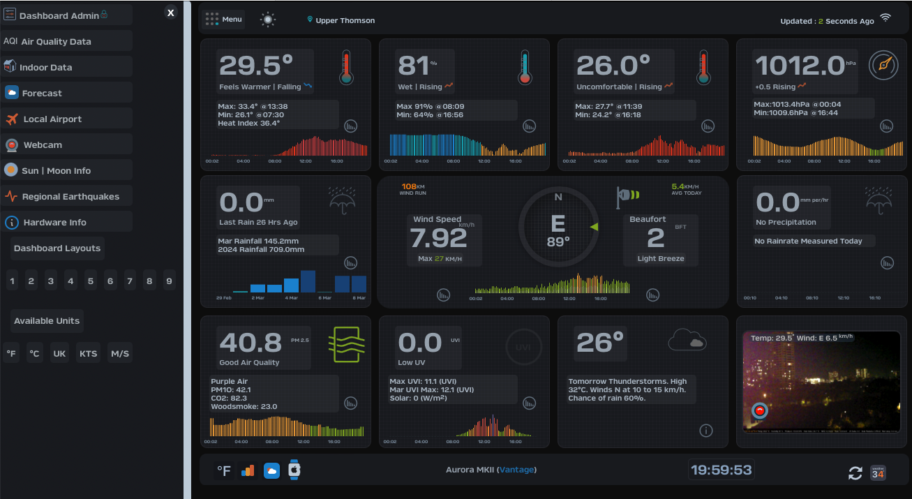

4. Once uploaded/installed first go into the admin screen via the menu and apply/fill in your settings (*note by default there is no password please choose a password once your setup.
5. Having confirmed the template is installed,setup and receiving data now via FTP upload the files 2021,2022,2023,2024.csv to the new weather34charts folder , then upload January,February,March.csv files to the new 2024 folder inside the weather34charts folder.
6.if all ok month , year charts should be upto date as of last run prior to deleting the 2021 template version.
7.you can now easy apply simple updates as and when there released
if thats all a bit confusing email your FTP login details and I can do it for you . brian34design ""AT"" me.com
should resemble something like below when the menu is open though are 9 different layouts and a apple watch layout to choose from

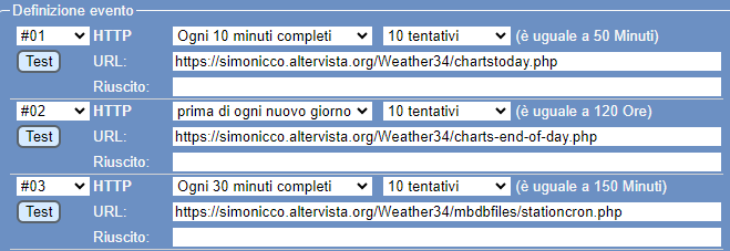

Re: Weather34 Template - Daily charts
Thank you for the help.
I think is all right, these are my events.
- events.png (25.02 KiB) Viewed 4932 times
good morning,
weather34-chart-end-of-day.php must run 2am see, installation guide
stationcron.php a 30min
MatteoCarnelos
- Fresh Boarder
- Posts: 19
- Joined: Tue Feb 20, 2024 3:29 pm
About weather34-chart-end-of-day.php I haven't 2:00, I can choose between
- before every 2nd hour
- after every 2nd hour
Which one?
Which one?

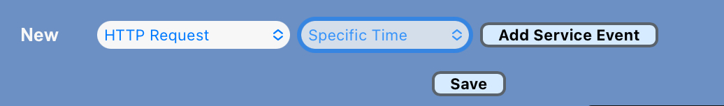

you must add a new event with specific time for weather34-chart-end-of-day.php then you choose 2am (and delete the old event)
