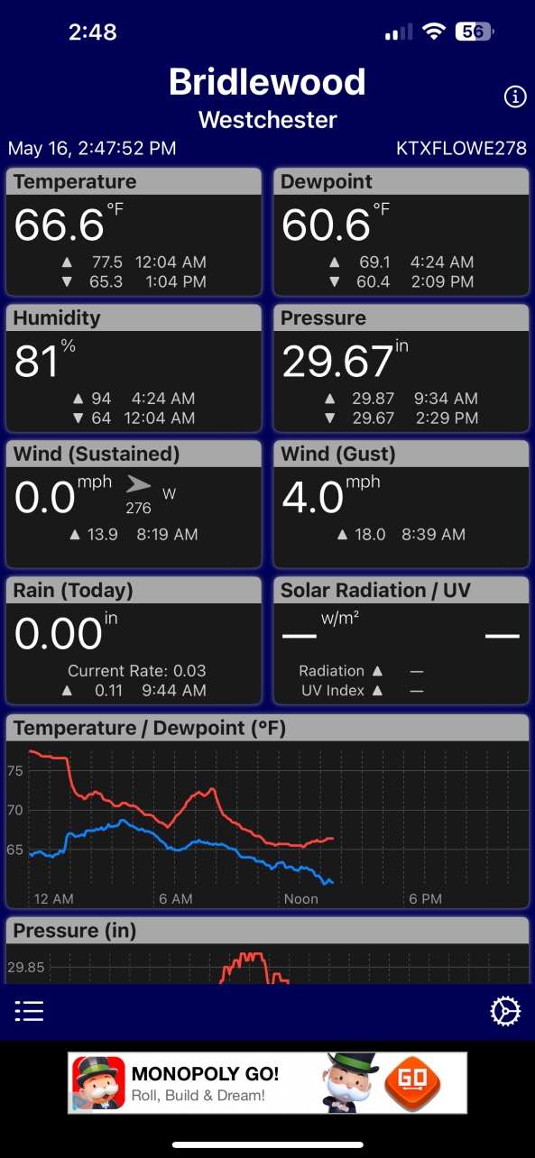

My setup: Davis Vantage Vue station (ISS replaced a week ago for other issues). Vantage Vue console & weatherlink console. Both read properly. My meteobridge is connected via LAN due to using WiFi-6 Eeros. I send data to weather underground, PWS & CWOP. The rain data is incorrect on all of these sites. They never show an accumulated total of rain. I get hourly reports, but they are often wrong. This has been happening for several months. Any ideas on where to look would be greatly appreciated.
- 2024-05-16 14.48.45.jpg (251.54 KiB) Viewed 4346 times

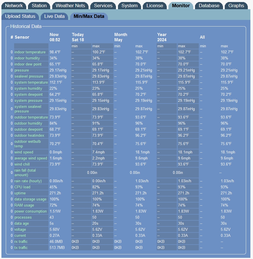

Re: Meteobridge Pro rain data to Weather Underground, et al is incorrect
Rainfall totals for Today/Month/Year & All can be found under the Monitor>Min/Max Data tab. Rain rate values (Min/Max) for Now/Today/Month/Year&All on same page
Totals are all zero, but there are some quantities under hourly.
- Screenshot 2024-05-18 085430.jpg (356.6 KiB) Viewed 4322 times
Data Storage Usage is 100% so would be doing some maintenance to lower that and make some spare storage capacity.

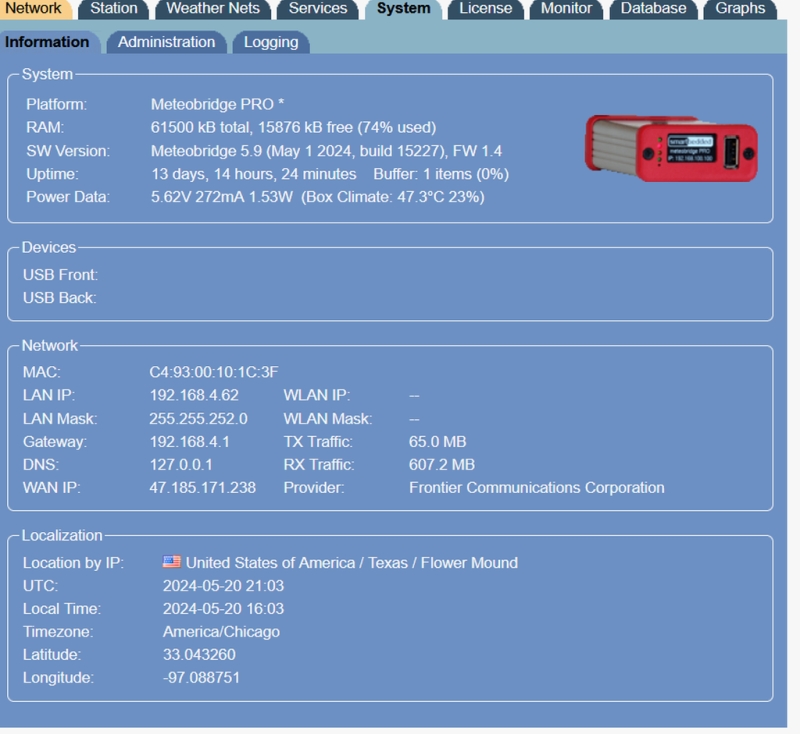

Here is the screen shot
- Screenshot 2024-05-20 160409.jpg (202.43 KiB) Viewed 4280 times
Dale G Elhardt AG6MA
Flower Mound, TX
I welcome change. But I prefer bills.
http://www.jetphotos.net/showphotos.php?userid=7702
Flower Mound, TX
That indicates you have an issue with the USB stick, the storage details should be between the RAM: & SW version details. Without knowing what the internal USB is (make/type/size etc) would suggest the internal USB might be best replaced.

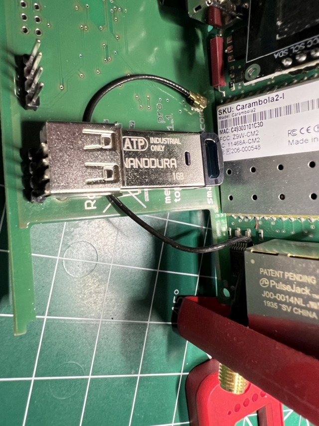

I can disassemble it to find out. If I do have to replace it, does it have to be formatted any special way?
Flower Mound, TX
Flower Mound, TX
No reformatting, simple straight out of the box.
There is a video of replacing the internal USB, have to seen this? https://www.youtube.com/watch?v=Wn0_tM_jjZI
There is also approved USB sticks. ATP NanoDura SLC's work fine with long life
Here is a photo of the memory stick. Interesting thing, when I plugged the MBPro back in, it said "formatting storage" then "formatting failed".
I just watched the video (after I took it apart). It showed pretty much what I had done. Very easy.
Does it have to be 1GB or can I go bigger?
