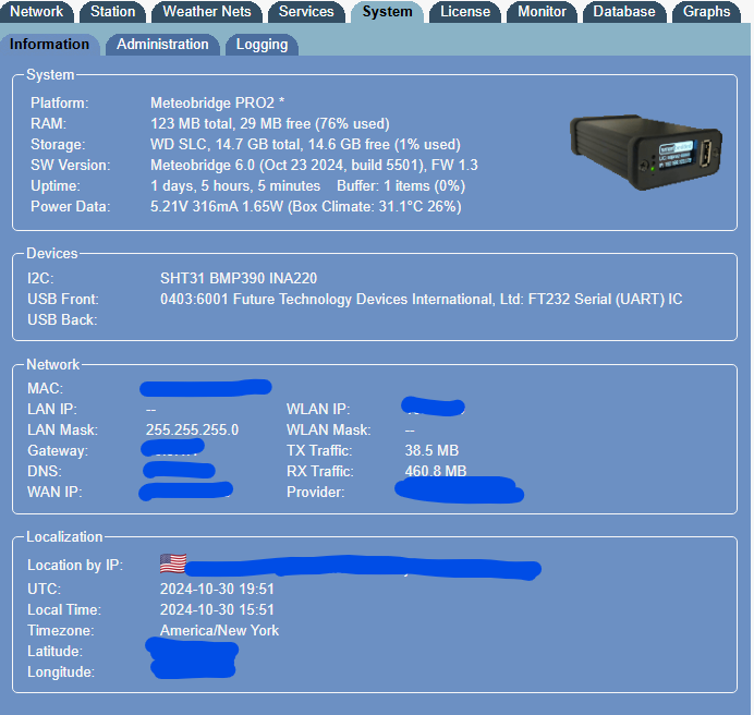

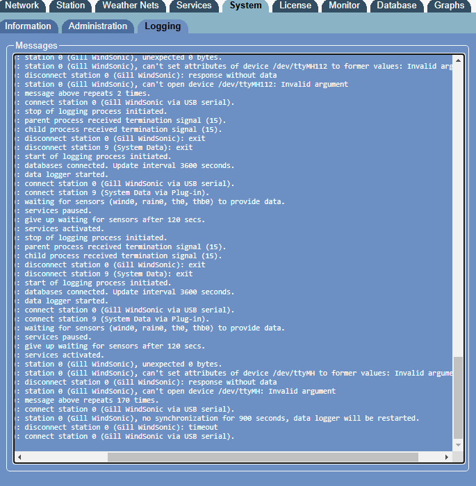

Are there specific settings required on the Gill unit for it to properly interface with the Meteobridge Pro2? I have a Windsonic in default configuration that is having trouble communicating. I've verified the GIll via serial to USB converter with a terminal emulator on a PC and I get the expected data packet. The serial to USB converter is recognized by the Meteobridge Pro2, but sensor data doesn't seem to be flowing. I do see an 'invalid argument' error in the logs. I've tried a different serial to USB and also used a powered USB hub with the same results. See screenshots below. Thanks in advance.

is your USB/Serial adapter FTDI based? Yes- see the system information screenshot above for verification.

When you give me remote login I can have a look. please mail credentials to "info(at)meteobridge.com".
It can be something with the USB serial converter or that Meteobridge expects not just to get wind data (which is too incomplete to feed any weather networks, which is the main purpose of Meteobridge) and therefore starts the data logging process over an over again. Do you intend just to log wind data or are you planning to connect another station that provides the rest (wind, outdoor temp, rain, etc).

After additional troubleshooting, I’ve been able to identify two configuration mis-matches between my Gill WindSonic ‘out-of-the-box’ settings and the current MeteoBridge WindSonic station configuration. My specific WindSonic unit is the WS60 Option 1- part number: 1405-PK-021.
1. Baud rate on the WindSonic defaults to 9600 whereas /dev/ttyMH defaults to 4800 on the MeteoBridge. I think 4800 is a better (more reliable over long cable length) setting, so I changed the configuration on the WindSonic to 4800 (B2) via the procedure described in the manual on the Gill website.
2. Message format on the WindSonic defaults to ‘Gill-Polar’ (M2), whereas the MeteoBridge appears to be expecting a NMEA format. Changing the message format to ‘NMEA, IIMWV’ (M5) seems to resolve the problem and results in accurate wind direction and wind speed reporting from the sensor.
With the above changes, the WindSonic sensor is now working as expected. The full working configuration on the WindSonic is: M5,U1,O1,L1,P1,B2,H1,NQ,F1,E3,T1,S4,C2,G0,K50.
One final question, can you confirm the correct NMEA format to be selected? As mentioned, using NMEA, IIMWV appears to work but there are several other NMEA formats available on the WindSonic and I want to confirm that the M5 option (per the manual) is the right format for what the MeteoBridge is expecting.
