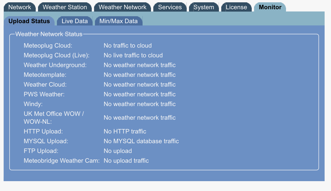

Can you please elaborate a bit more what exactly is not working?
Is it the weather network uploads? Which?
Is it defined events? which? What does "Monitoring - Uploadstatus" tell?

I renewed my licence and updated to 6.0 yesterday evening, and all network traffic has ceased and consequently my website is not being updated.

Hm, looks like no weather data coming in, which as a consequence does not trigger uploads (no data, nothing to upload). But this is just guessing based on the little details you provide.
Fastest way to resolve this would be if you grant me remote access. Please send credentials to "info(at)meteobridge.com" (FAQ explains how to enable remote access).

Thanks for providing remote login and as often I found the issue within a few minutes. It was a bug in the installer which only impacted the TP-Link router platforms. It is fixed with just released update.
Sorry for the hick-up (I should have discovered that on my own before releasing 6.0) and thanks for raising the issue.
