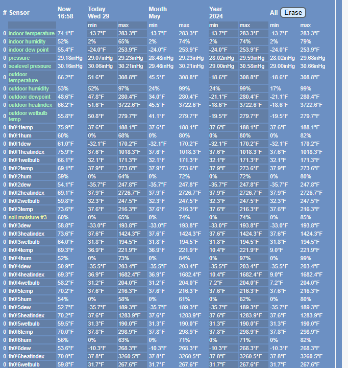

"Meteobridge update 6.0 corrupted when an Ecowitt WH46 sensor is connected"
Platokidd
Posts: 20
Joined: Sat Feb 06, 2021 7:17 pm
Post by Platokidd »
metoebridge 6.0.png (144.21 KiB) Viewed 5429 times
Platokidd
Posts: 20
Re: Meteobridge update 6.0 corrupted
Post by Platokidd »
Thought I would add model of the Meteobridge. Ambient Weather branded TP-LINK TL-MR3020(un) ver. 1.9
Everything was fine until restarting and updating to 6.0.

Rolling back to 5.8. Too many issues with 6.0 Corrupt MIN /MAX data. Tried to erase all and start over. Nojoy.
5.8 so far is holding min / max data normally. Fingers crossed.
Platokidd
Posts: 20
Post by Platokidd »
Think I may have figured this out.
I added a Ecowitt WH46 Air Quality Sensor recently. This replaced the Ecowitt 45 air sensor. https://www.amazon.com/dp/B0CSSJDJYX?ps ... ct_details
Now I removed the sensor and no longer sending it's data to the meteobridge.
Been about an hour and so far, all is good. This is on ver 6.0.
Is it even possible a sensor could mess the meteobridge up that bad??

Re: "Meteobridge update 6.0 corrupted when an Ecowitt WH46 sensor is connected"
Thanks. Ecowitt just provided me with their current API docs and indeed the WH46 is new in there. Response from Ecowitt was really fast. Thanks for that.
I implemented support for WH46 in just released Meteobridge update. When WH45 and WH46 are present last one in the data stream will be right (data gets overwritten). For the moment Meteobridge ignores the PM1 and PM4 data the WH46 provides additionally, PM10 and 2.5 should be good enough.

admin wrote: Sat Jun 01, 2024 5:44 pm Thanks. Ecowitt just provided me with their current API docs and indeed the WH46 is new in there. Response from Ecowitt was really fast. Thanks for that.
A WH45 and a WH46 cannot be present/registered at the same time in the same console ! It's either or.
