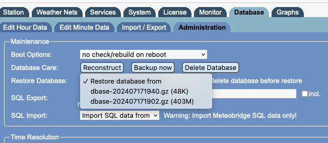

I think maybe I have figured it out. The backed up database of the RPi is not compressed, whereas the backup on the VM output (which it stores locally, not to a USB) is a .gz compressed file. So I have compressed the RPi database and am now uploading it via the Admin -> Maintenance -> Media Access -> 'Upload Files' -> backup.
It's going really slow because it's a pretty large file, but appears to be working - hasn't crashed yet! I'll know in a little bit if this is the solution. It does show up in the VM Database -> Admin -> 'Restore Database From'. But it's a little strange because there doesn't seem to be a way to delete these backup database files?

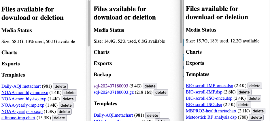

This does work to transfer the database, but there appears to be inconsistent export / import behavior across my devices (RPi3, RPi4, and VM) so it's a bit confusing. For example, only the RPi4 displays the Backup directory with the exported sql-files in the 'Files to download or Delete'.
Screenshot 2024-07-18 at 1.15.01 AM.png (144.49 KiB) Viewed 3677 times
Also, do you know if it's problematic to transfer a database from an RPi to a VM? I notice that the RPi databases includes more sensors (for hardware monitoring, etc) and these are not included in the VM database. Will this matter?

I would recommend to use the new but rather slow export / import SQL feature. Backup/Restore does a binary copy of the database file and that might not work between all CPU architectures.

Also, any idea why the "Backup' header and corresponding files for download or delete don't show up in my RPi3 or new VM Meteobridge, but they do on my RPi4?

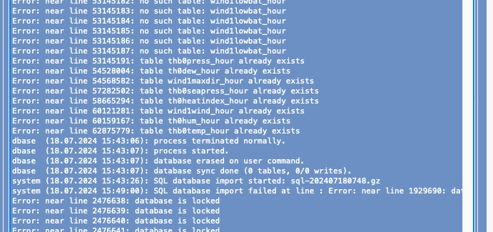

I tried again, and it failed twice. The error messages go off the screen, so I'm not able to capture them with the screenshot as the logger window is a fixed size.
Here I tried to import the database, which failed. So I deleted the database, and re-imported it from the sql-dump:

system (18.07.2024 15:49:00): SQL database import failed at line : Error: near line 1929690: database is locked
Error: near line 2476638: database is locked
Error: near line 2476639: database is locked
Error: near line 2476640: database is locked

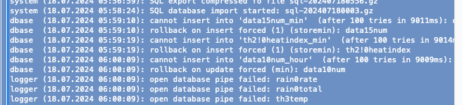

Re: move existing database to VM meteobridge
Looks like some database job kicks-in in parallel and locks the database. I will inspect this on my system.
Could you please provide me the gzipped sql you tried to import? I tested with smaller ones and that worked fine.

However, I still do not see any of the files under the "Backup" header using the 'Download or Delete Files' selection. It works fine on the RPi3, but both the RPi4 and the VM do not list the files. So you can't download or delete any of the backup files on the RiP4 or VM, making it really difficult to transfer the databases or sql.gz to another instance or save for backup on another computer or server.
