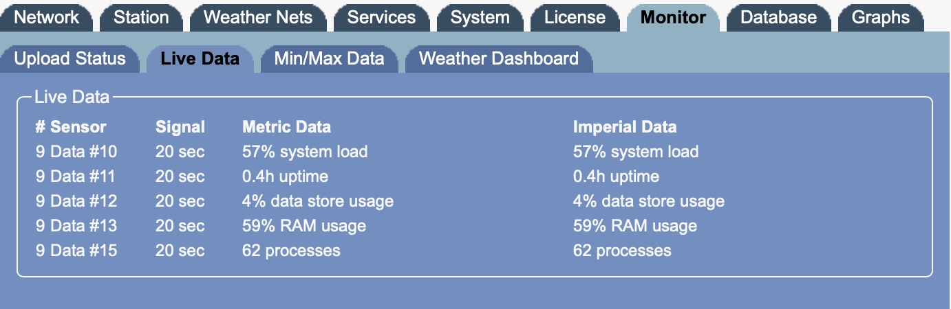

I´ve had the Nano SD in a Vantage Vue for two years, never had any problems. A couple of days ago we had a blackout and after that the MB won't get any weather data from the Vantage.
Anyone got any idea what to do?
Live data
Live data
Bild 2024-07-23 kl. 17.29.jpg (142.71 KiB) Viewed 1944 times

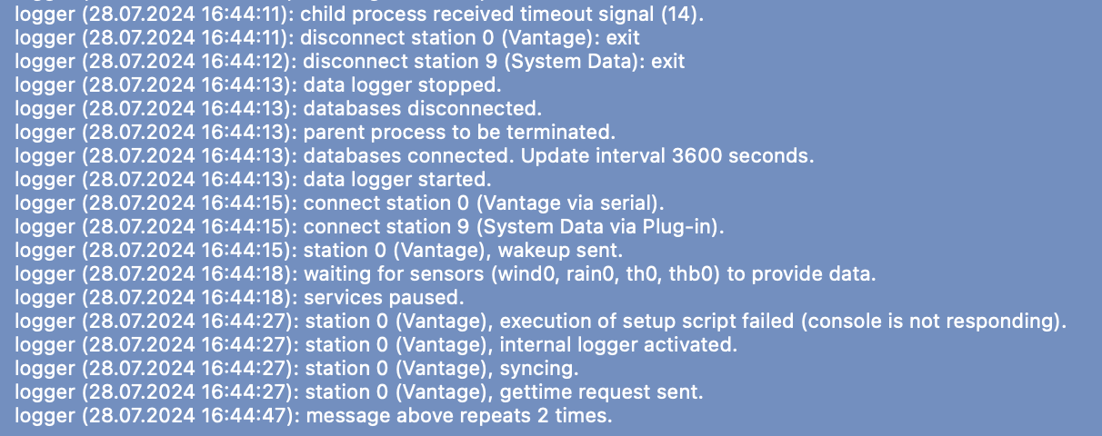

This is what the latest logg looks like.
Skärmavbild 2024-07-28 kl. 16.45.46.png (216.43 KiB) Viewed 1887 times
Re: NanoSD missing sensors
Please power-cycle console (including removing batteries).

Inplugged the console and removed batteries for almost 24h. No change after that.
Fact is, that the console is not answering the NANO. I doubt that comes out of nothing. Did you check if the NANO sits tight in the slot?
