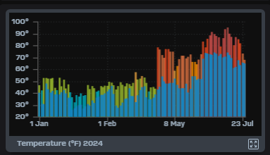

I have gaps of missing data in my Charts. Focusing on 2024, how do I import the missing data from my Meteobridge NanoSD?

I'm circling back to my earlier question in July to see if anyone has some thoughts on how to restore missing chart data, in particular, missing data in 2024 Charts. I found this attached text where Brian mentions a script that Boris came up with to export data that may be used to possibly restore lost data? Any thoughts?

I have already written my method to fill in any gaps. However, this only works with MB Nano and Pro. You then have to replace the year in the URL.
Copy the script to meteobridge/data/templates.
viewtopic.php?p=48390#p48390

Worked like a charm and my charts look great! Thank you @ ToTo. Much appreciated :)
