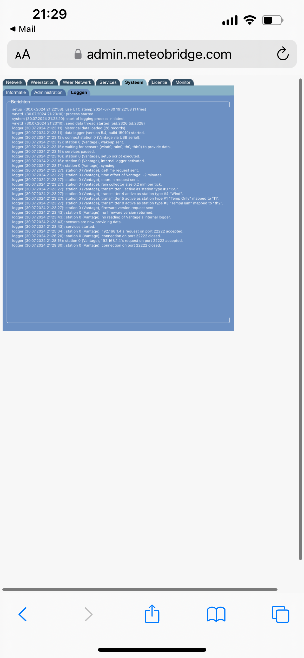

Hello, I have several weather stations, all equipped with a Meteobridge (most TL-MR3020) and a Davis Vantage Pro2 station.
Every few weeks the communication drops out and I have to restart the Meteobridge.
I have the same problem in two different locations, one with a TP Link MR3020 and one with a D-Link DIR-505.
Sometimes it takes a few weeks, sometimes just a few days before the device has to be rebooted.

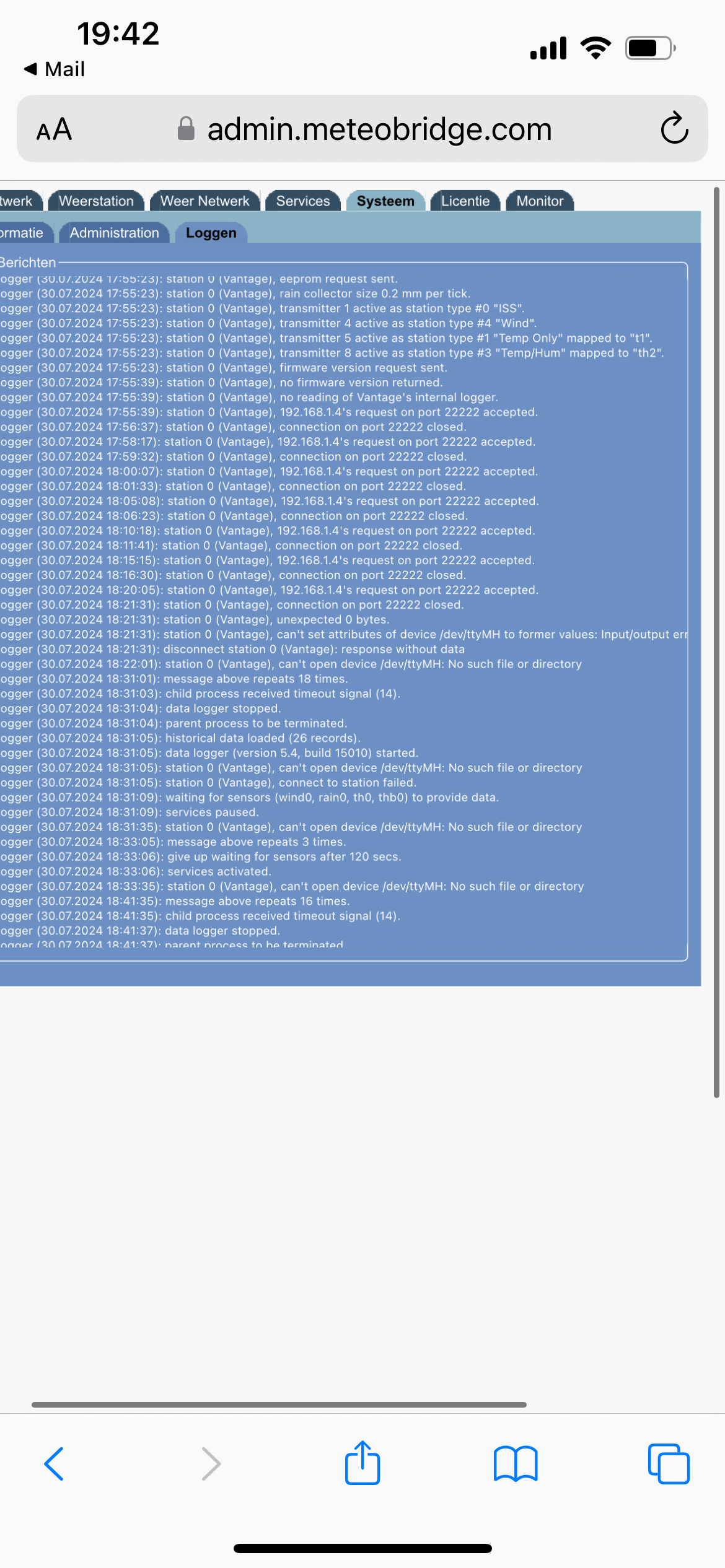

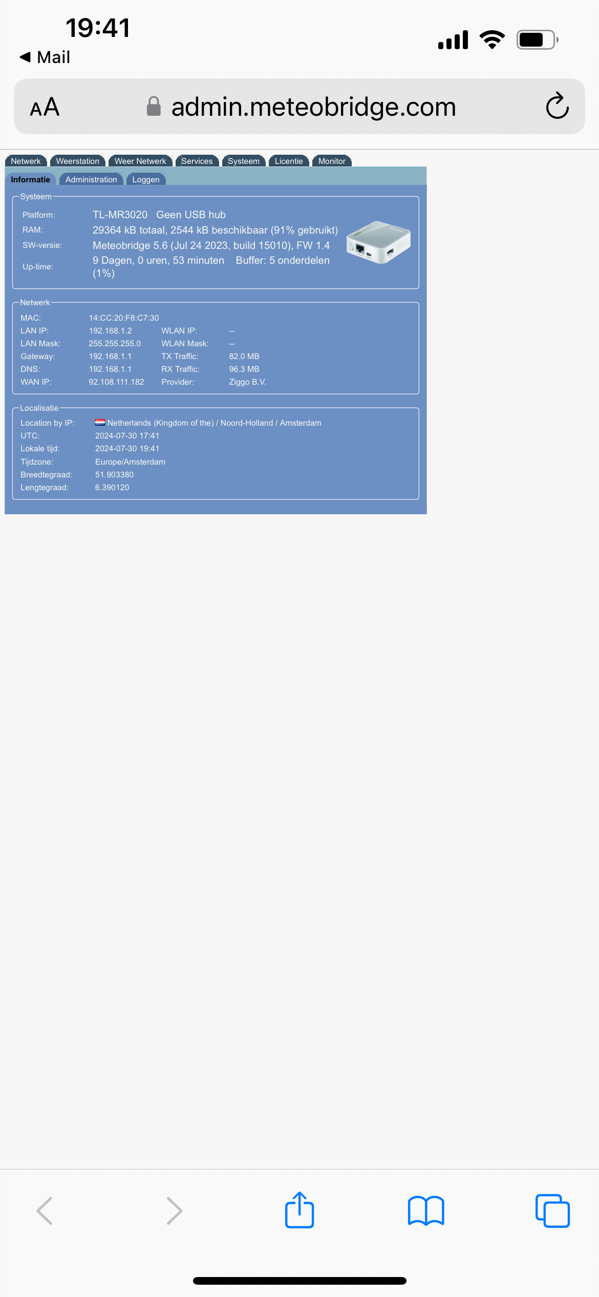

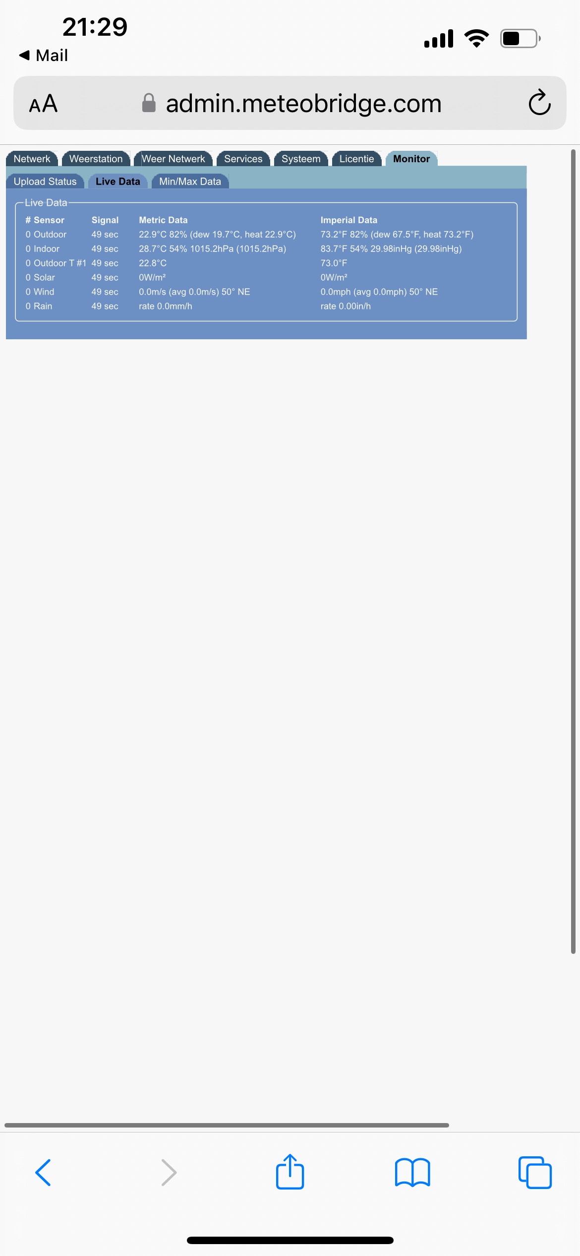

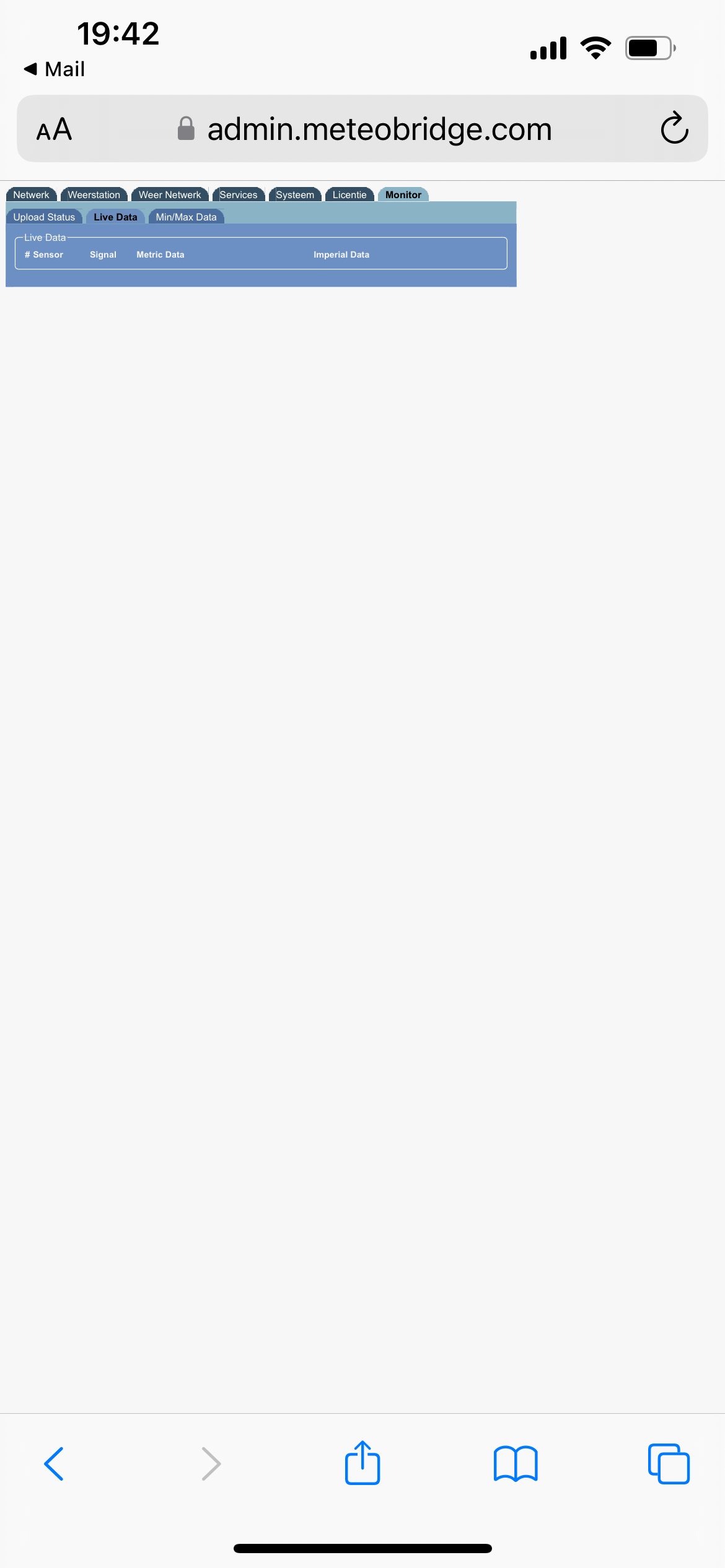

Yesterday, the problem popped up again. I decided to take screenshots. I am curious to know how to solve this persistent problem. Is it due to the USB hub used to connect the Davis VP2? Or is this another problem?
I hope you guys can help me.
Thanks in advance.
After rebooting:
Before rebooting:
Re: Meteobridge connection drops out Davis Vantage Pro2
Can you please stop your PC trying to connect to the Meteobridge on port 22222. Doing so all should work fine.
