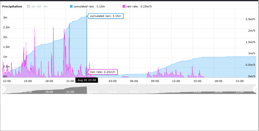

I'm trying to create a custom chart that will show me the rain rate, daily rain total, and monthly rain total for the last 48 hrs. I noticed that when I use either [rain0total-monthsum=in.2:0], and the time period is say Aug 4th through Aug 6th, both of those are giving me the sum of rainfall for Aug 4th-6th, not monthly total at 8/4/24 12am, then monthly total as of 8/4/24 1am, etc. In essence, it's summing the rainfall for the time period that the chart is displaying, not the rainfall since the first day of the month.
The same thing happens for daysum periods where the start of the graph isn't at 12am (ie, graph is from 7am to 7am cuz it's the last 24hrs).
Rain last 48 hours (rainfall for Aug 5th begins after the chart begins):
rain last 48 hrs.png (28.68 KiB) Viewed 3981 times

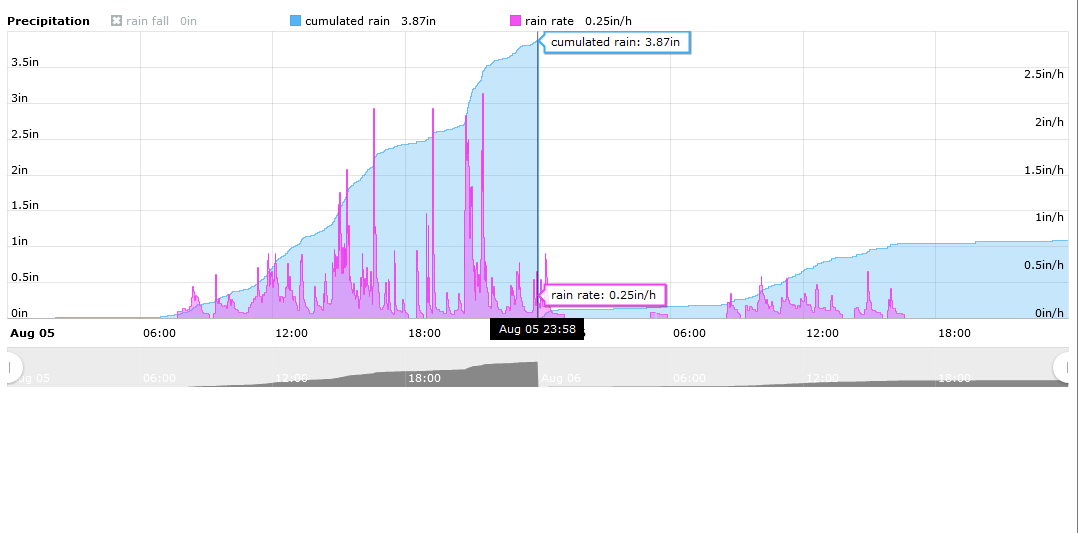

Rain last 36 hours (part of the rainfall for Aug 5th is before the chart beings):
rain last 36 hrs.png (30.24 KiB) Viewed 3981 times
Based on the text from the Templates page, I would think that these sums should work even if the first day of the month or minute of the day isn't in the chart time frame that's being pulled.

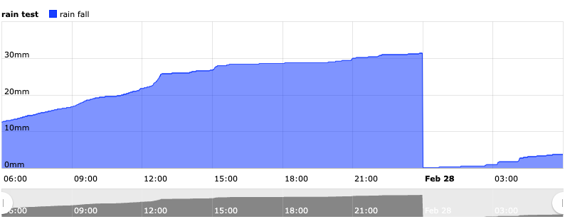

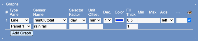

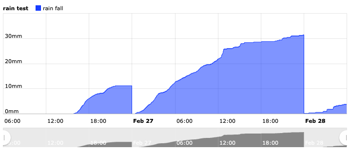

I tested on my Meteobridge and given this chart definition
I get this graph which shows raintotals summing up for each day.

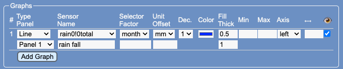

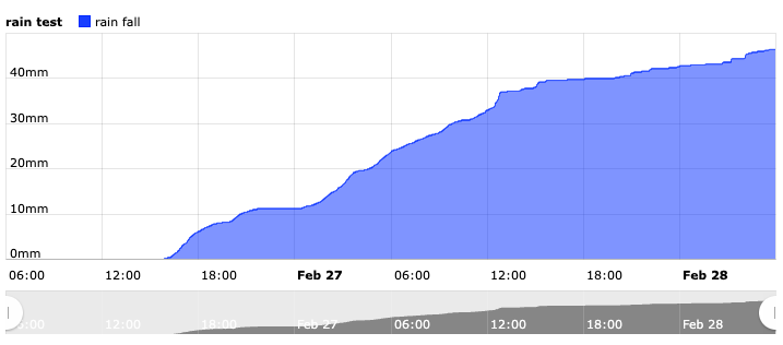

When I use "month" in the definition as shown here
I get a summing up over the month.
This all looks like to be expected.
The URL parameters I used are:
http://..../public/chart.cgi?chart=raintest.metachart&res=min&lang=en&start=2024022606&stop=2024022806

I invested some spare time today to implement the requested feature, where also "raintotal" data outside the specified inspection interval is taken into account when using "day", "month", "year" selectors.
Please give just released update a try.
Definition:
URL:
http://.../public/chart.cgi?chart=raintest.metachart&res=min&lang=en&start=2024022706&stop=2024022806
Result:
