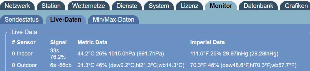

The Meteobridge Pro reads all data correctly except of the humidity (always ~47%) - that's to low (the dew point too).

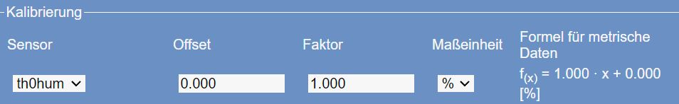

I have restartet, rebuild database and calibrate on both MBs the Humidity Sensor (offset = 0, factor = 1).

MB-Pro (incorrect Humidity)

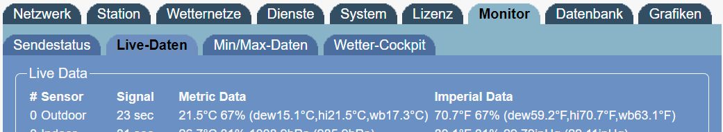

MB-Nano (correct Humidity)
Calibrate MB-Pro.jpg (14.67 KiB) Viewed 3023 times

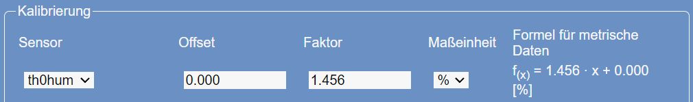

I applied now this workaround:
Multiplied by "1.456" I get same "MB pro humidity" as the Davis Console and Nano SD.
