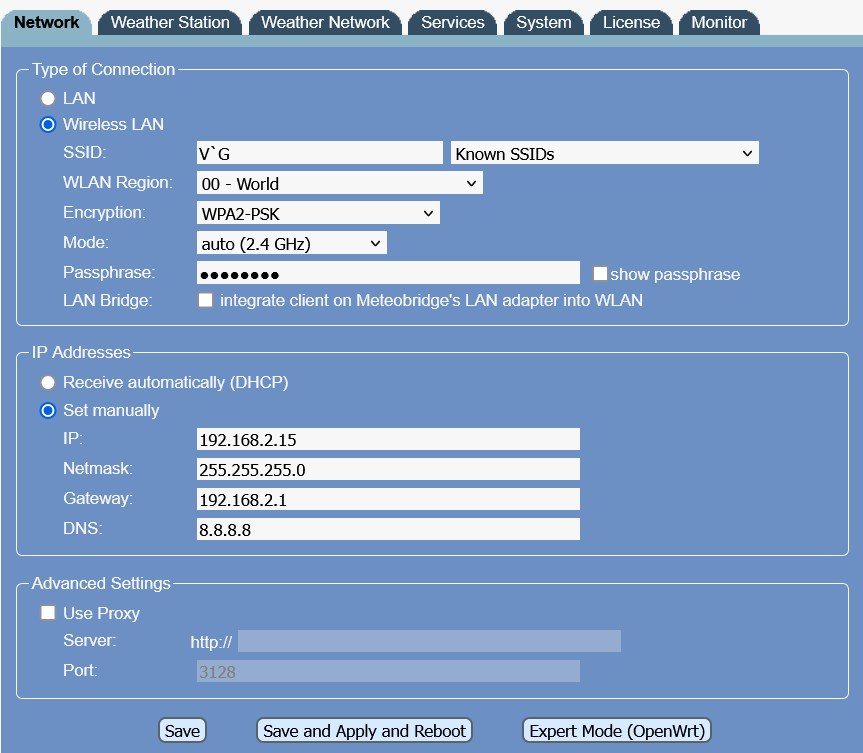

To be honest, I don't know exactly because it's not like I have knowledge about this matter. The only thing I know is that since I installed meteobridge, I haven't changed any IP address or anything.
If you can check, I can send you remote login!

Hope this helps!

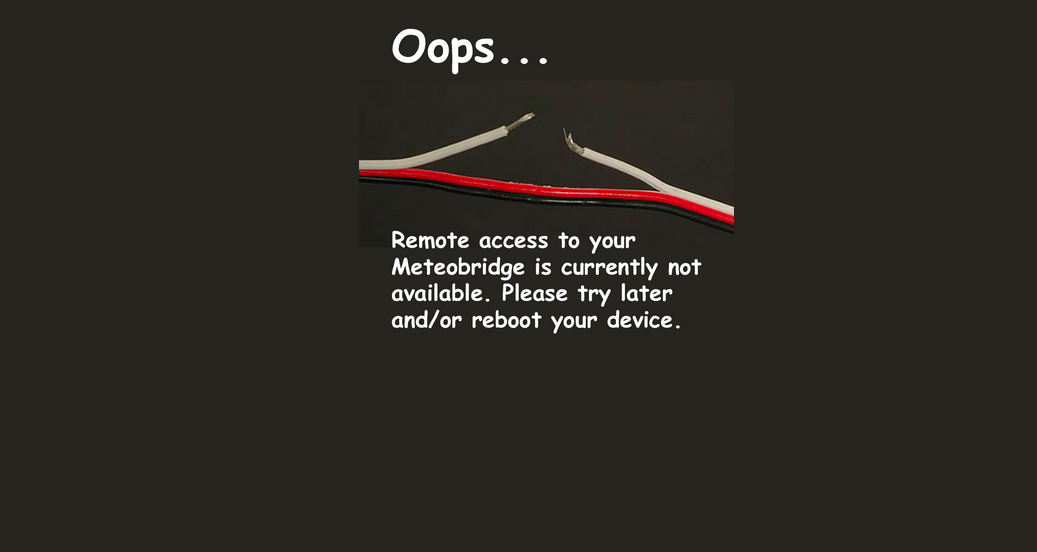

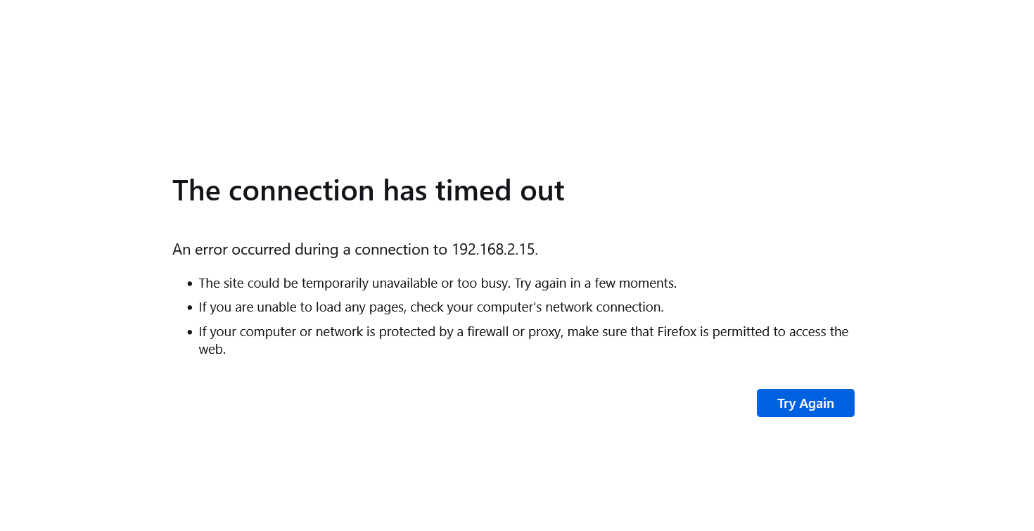

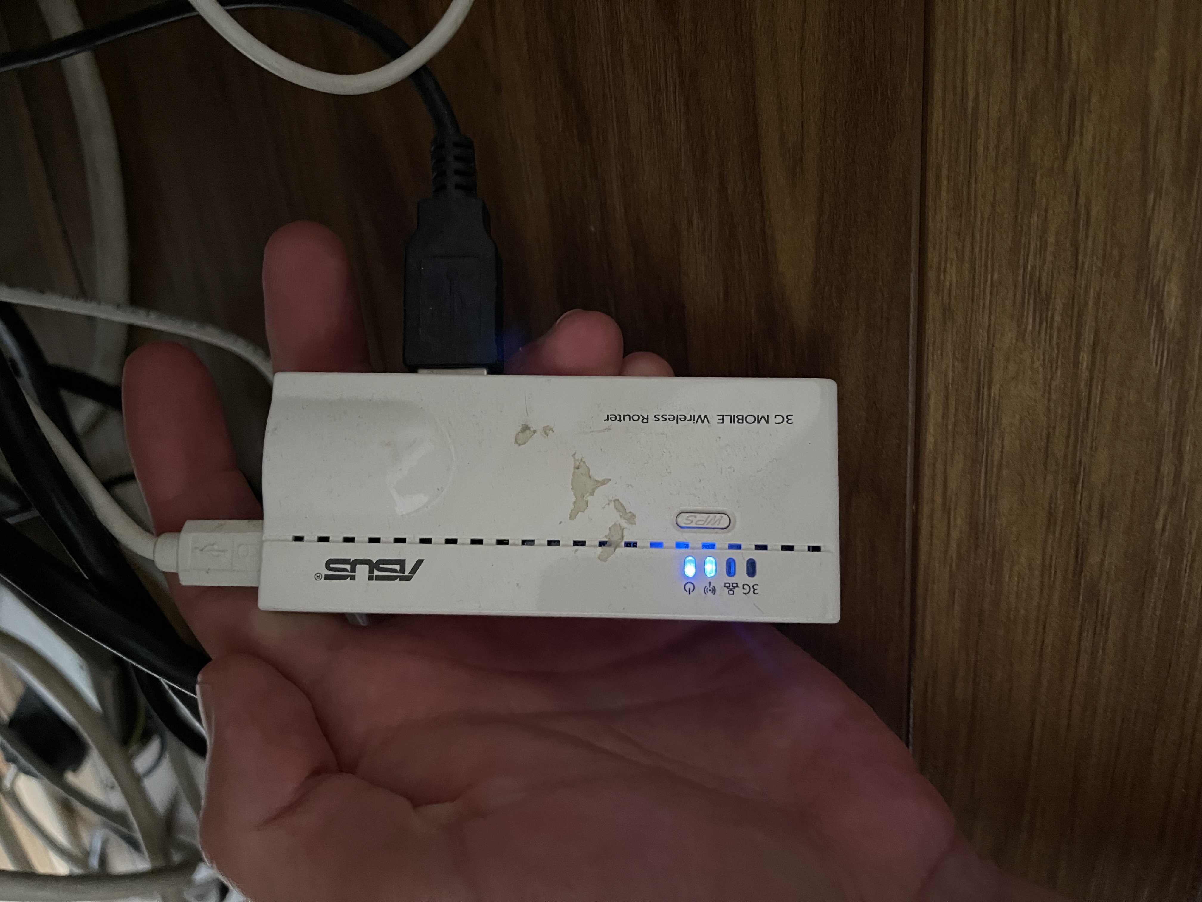

And here we are again. It was working since September 16, while today at 05:45 it stopped working, and while I'm still having internet and I'm writing this, meteobridge doesn't open at all. The remote login doesn't open either.
1. The page isn't opening at all while I'm having this problem.
2. The remote login link isn't opening as well.
3. Since I don't have access, I can't know. Normally, I believe not as long as it stops working, I'm even getting emails from awekas that I haven't sent the weather data to them. Also on Wunderground, I can't see the weather data.
4. If you are talking for my device (WL-330N3G), it's showing large LED constant, remains the same as when it is working.
Can you help me with this, please?

Must be something specific to the Asus Device. I don't have one anymore to test. Those are EOL for years. When you give me remote access I can check if it is something about filling up resources. Those devices are operated much on the edge in terms of RAM.
