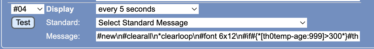

I have 2 nano and 1 pro meteobridge. Several "Select URL for http" events are not consistently firing since may of this year (mostly on the 2 nano). Even when i press test it does not seem to be firing as the data it updates does not get updated. If I put the url in a browser and send it, the data does update. haven't totally verified but i think it might be when the event is the last in the list. any other reports of this? I'm using the 3 events that update weather34 template.
also i see this weird event at the bottom of the meteobridge pro list of events that I did not add. see attachment

- Screenshot 2024-09-16 at 9.50.44 AM.png (44.8 KiB) Viewed 966 times
Re: Events not firing
That is a OLED display event. Data provided there constructs graphic on the OLED. Meteobridge Wiki explains syntax. If you don't need this, just delete the event.
