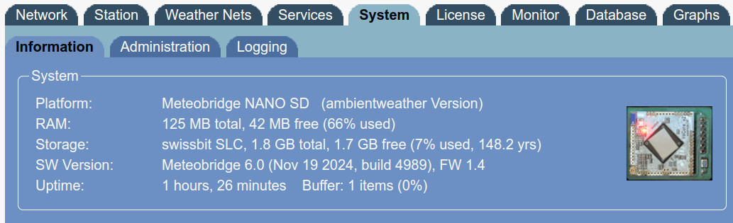

After today's update of my MB NANO SD, today's rainfall total is showing off by .03
See MB_Version.jpg for the current running version.

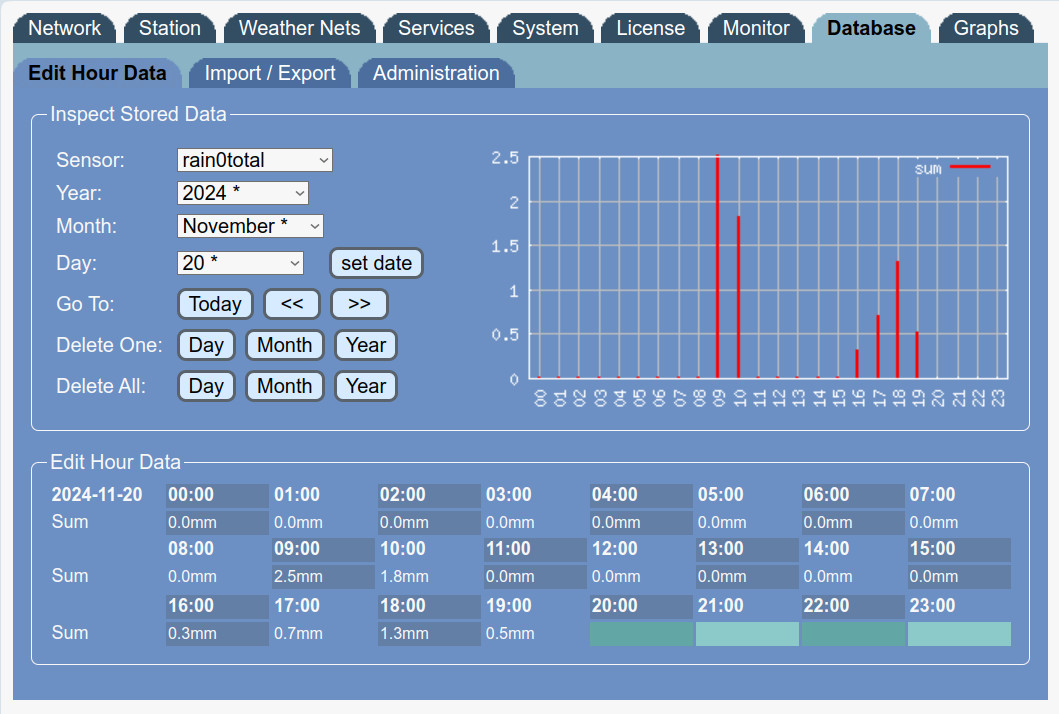

Note the 20 Nov data.

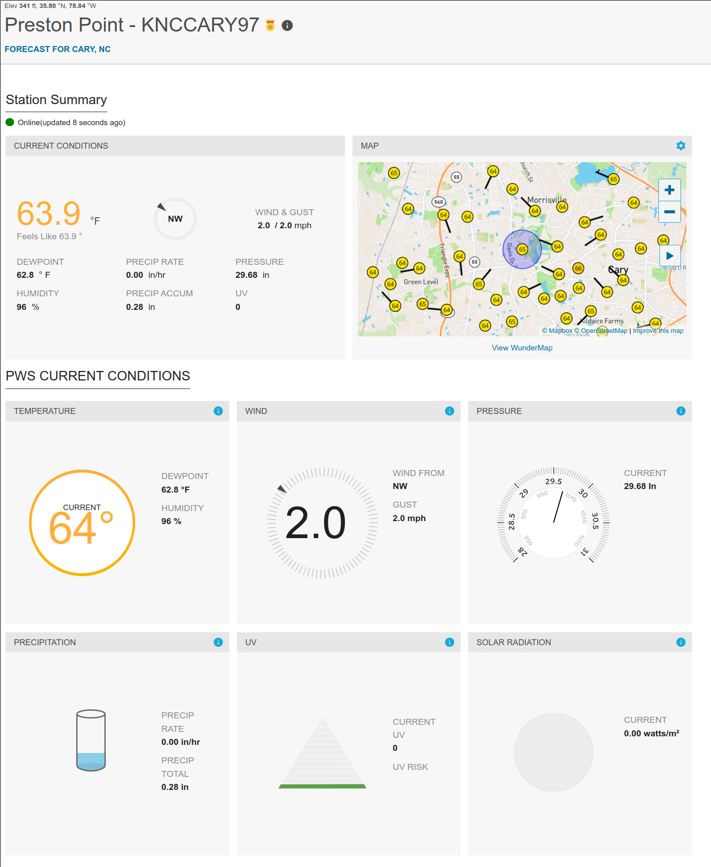

Upload to Weather Underground also shows off by .03: (Wunder.jpg)
I have also attached the MB page for the live data (MB_Rain_Data.jpg.
