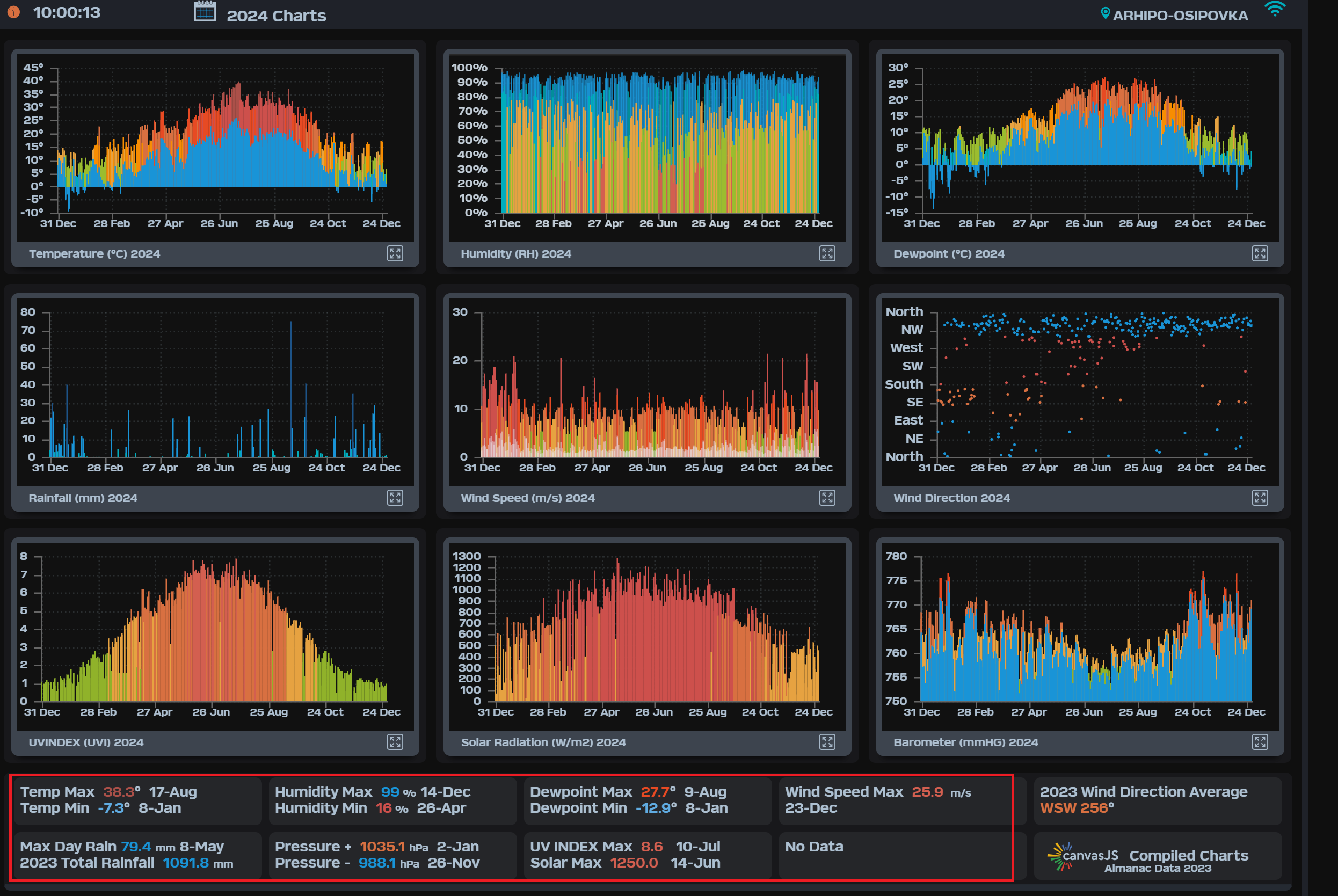

Hello everyone. Can you tell me: has anyone encountered such a problem (missing 2024) after the onset of 2025? Just yesterday, he was still there...
- Screenshot 2025-01-01 112641.png (280.7 KiB) Viewed 9374 times
- Screenshot 2025-01-01 112007.png (323.01 KiB) Viewed 9374 times

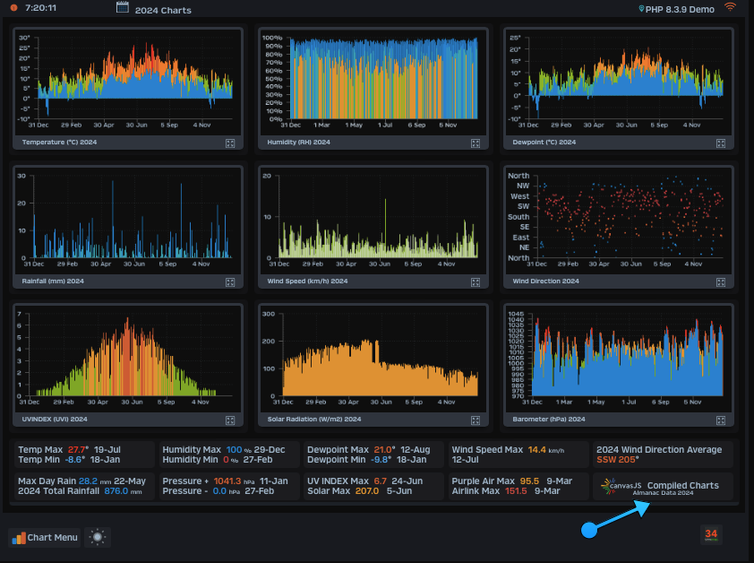

..screenshots

- Posts: 1824
Re: The "missing" year 2024 in the Weather 34 template
Simple Update December 2024 download link
https://www.mediafire.com/file/qtdd4sd8 ... e.zip/file
1.2024 charts
2.minor PHP changes
3.preparation for automated solution to new year showing previous year charts (will complete by end of January).

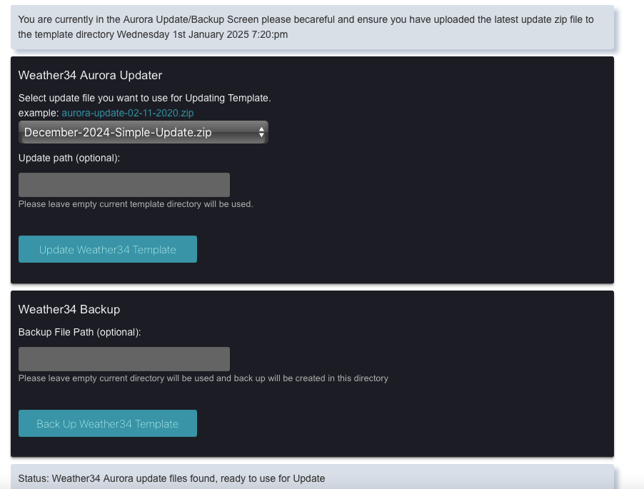

4.this update will appear in due course through meteobridge admin panel along with a updated Master version.

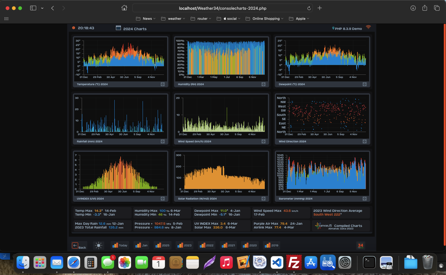

ps Paul Wilman I updated your site
https://www.paulwilman.com/pw/consolecharts.php
brian

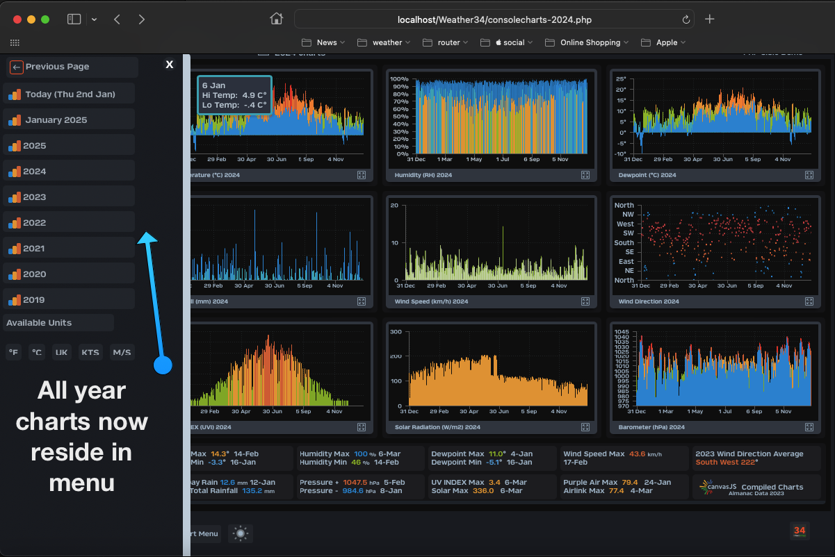

- Posts: 1824
Good afternoon..
so for end of January a release will have the year charts accessible via the menu , obviously has every year passes the bottom bar becomes congested ,also having the charts in the menu only requires once file to be updated instead of each year page.
also have added chart data compatibility till 2027 so no more new year no previous year chart access until end of 2027 . !! after that who knows
also Boris has added the last December 2024 update to the meteobridge admin screen. note this new update will come at end of January 2025 gives me a chance catch any issues or missed code without rushing it.

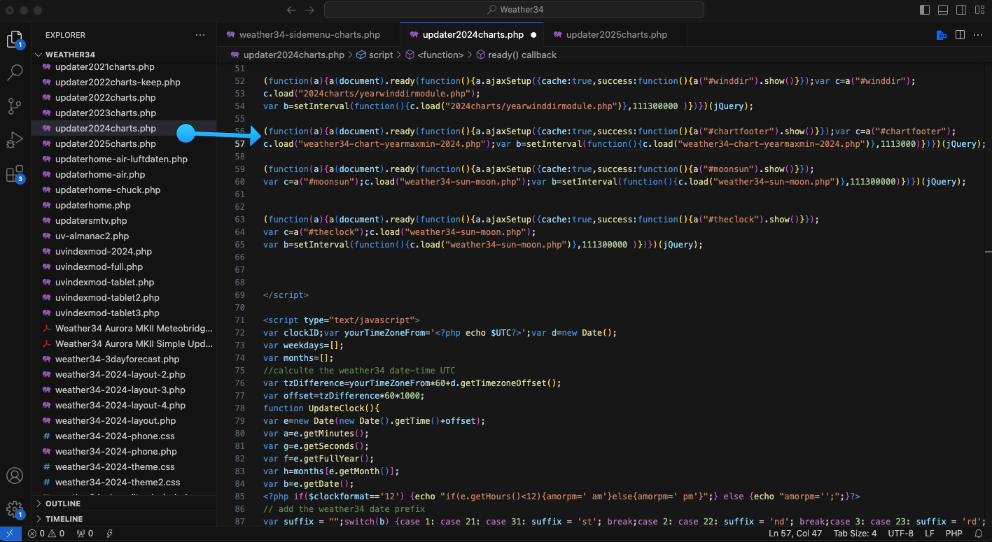

Hello Brian,
Thanks for the update and all the best for the year 2025!

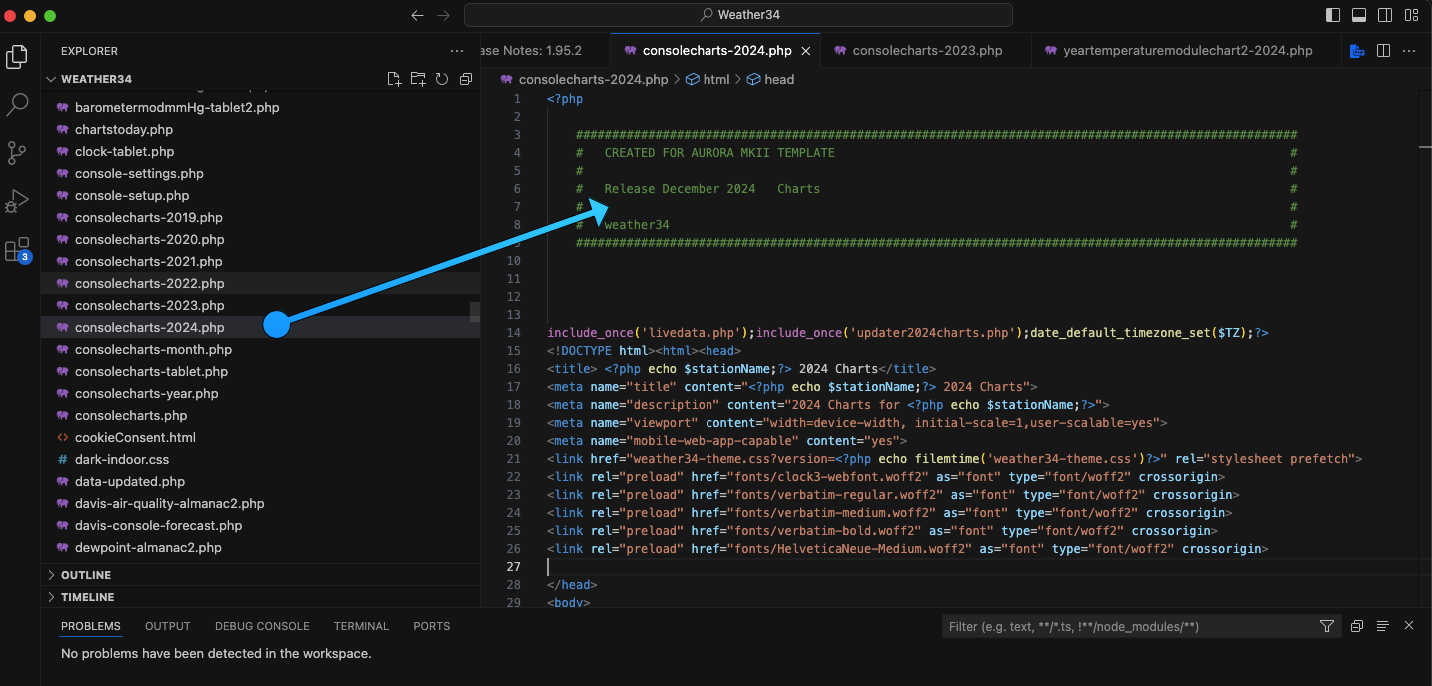

In Chartview 2024 the min/max are from 2023, in updater2024charts.php you must fix the weather34-chart-yearmaxmin-2023.php in weather34-chart-yearmaxmin-2024.php
- Posts: 1824
Good morning Toto
many thanks I knew I saw something 2023 in that file but completely forgot about it and I was struggling to find where there date for the almanac year was coming from now I know so thanks for the input .more eyes the better.
this will correct itself in the end of this month update so allow more time for things/issues like this to be corrected..many thanks and you too have a prosperous 2025 ..brian

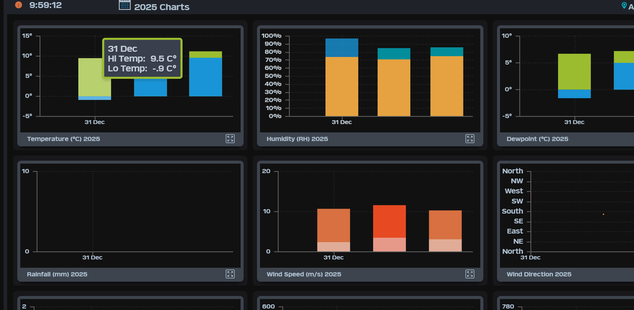

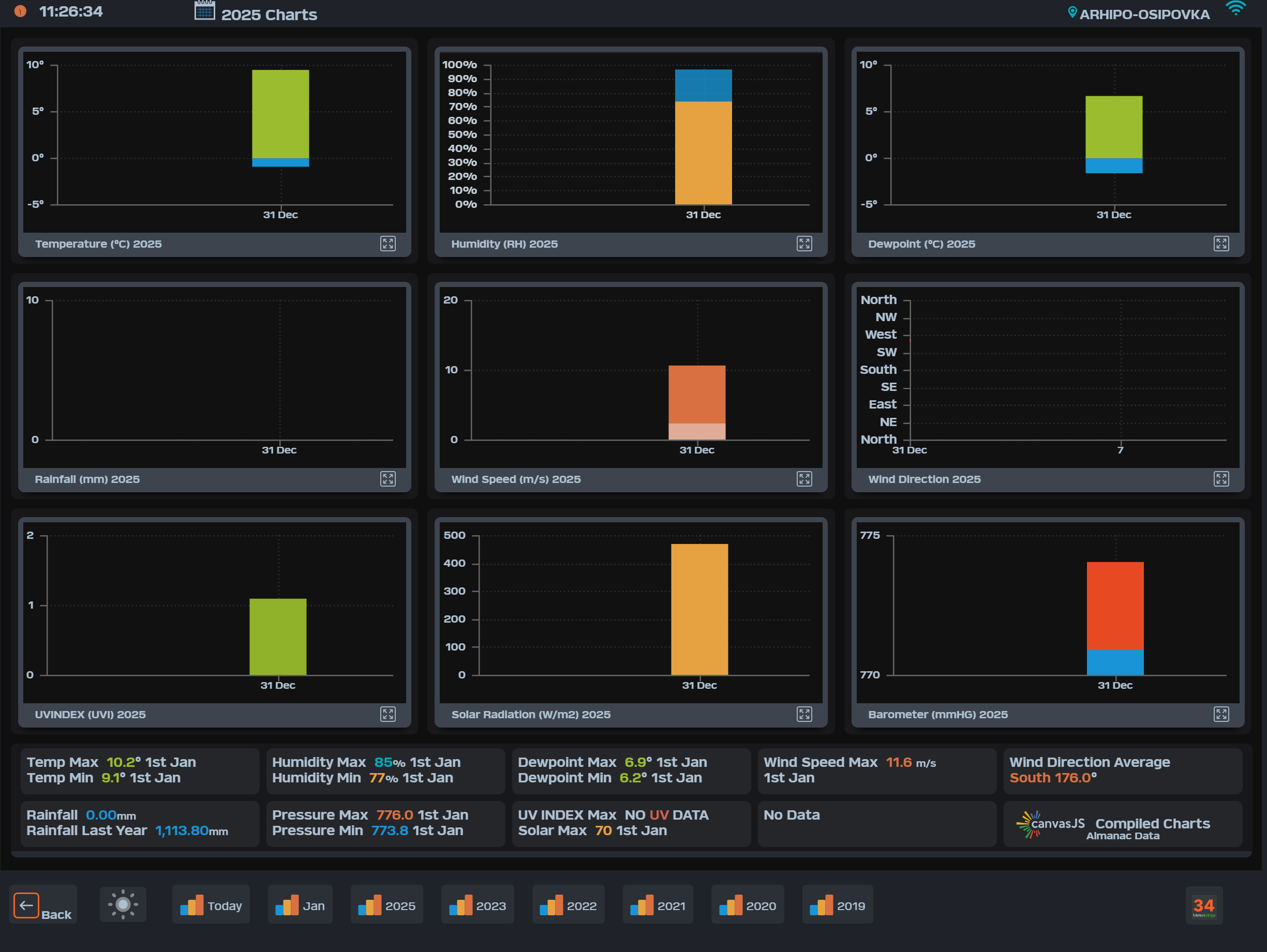

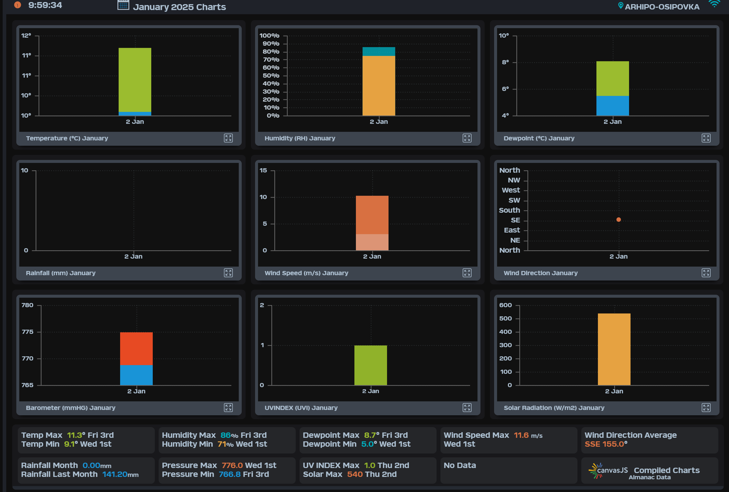

Hello, Brian! I've noticed that in the charts for January, the first of January has disappeared. And the charts for 2025 have it.
- Screenshot 2025-01-03 095917.png (139.5 KiB) Viewed 9192 times
- Screenshot 2025-01-03 095937.png (266.52 KiB) Viewed 9192 times

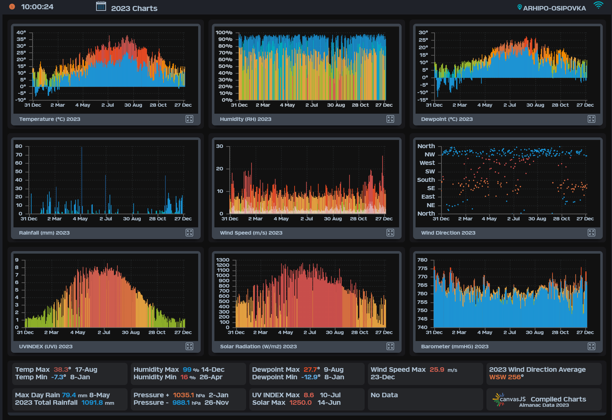

Here's another thing: the lows and highs for 2023 and 2024 are the same.
- Screenshot 2025-01-03 100028.png (485.82 KiB) Viewed 9192 times
- Screenshot 2025-01-03 100016.png (483.96 KiB) Viewed 9192 times
