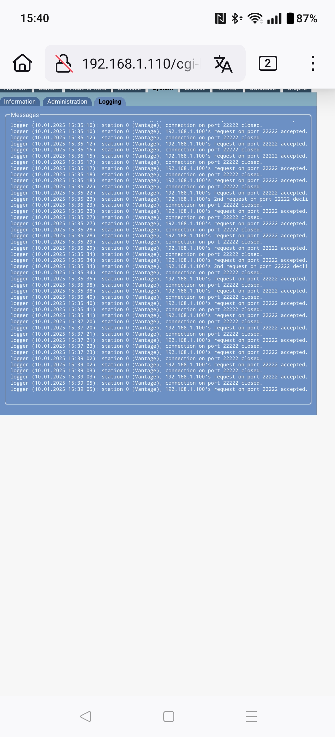

The logger stalls when a second connection is detected
So the closure of the connection has not been established when a new connection is made
This only happens when a second connection is detected in a serie
Now I'm using 5.9 and no problems sofar with logger
I do get some second connection declined in the log but not sequential

Thanks. Is the screen dump from 5.9 or 6.1?

5.9
On the newest version I got the connection declined
Message repeats 2000+ times, I do not remember the exact number
Then message that station connection cannot be established timed out I think
As a result of this the data is not collected
And a restart of the meteobridge logger is needed
