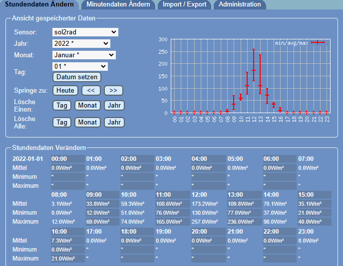

I have problems with the export. I have a template with the following content:
# Standard CSV template with data in metric units
# date, time, sol[w], temperature[C]
[YYYY]-[MM]-[DD],[hh]:[mm],[sol2rad-avg:],[th0temp-avg=C.1:]
The written file, however, has no Data:
2022-01-01,00:00,,
2022-01-01,00:30,,
2022-01-01,01:00,,
2022-01-01,01:30,,
2022-01-01,02:00,,
2022-01-01,02:30,,
2022-01-01,03:00,,
2022-01-01,03:30,,
What could be the reason for this? The data from both sensors exists.

Possibly trying to export 30 minute data when there is no 30 minute specific data?
You appear to be exporting from the Database>Import/Export tab using Custom Export in 30 minutes? Try changing to [Hour] and if not then lets know exactly how you have the Export configured and from where?

Mattk wrote: Wed Jan 29, 2025 4:56 am Possibly trying to export 30 minute data when there is no 30 minute specific data?
Hello, thank you for the quick reply. The solution was too simple and I can understand the reason very well. Maybe you can help with this too, otherwise I'll start a new topic. I want to output the number of summer days that are over 25 degrees in a template. Is that possible? I haven't managed it yet.
Many thanks. Regards, Thorsten
