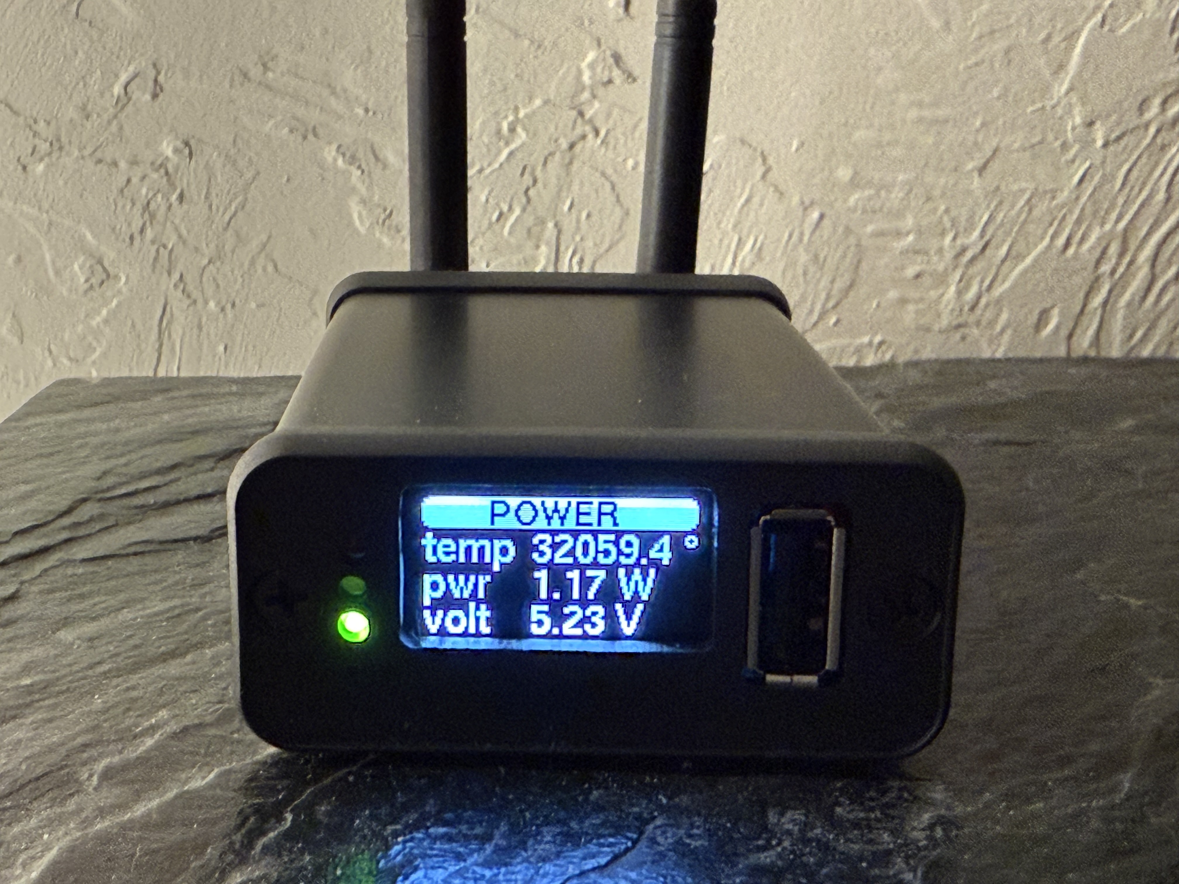

On the POWER display page showing
temp 32059.4º
pwr 1.17 W
volt 5.23 V
Re: MBPro2 running warm
I would expect it to glow at least a bit red.
Can you please give me remote access so that I can check what is going on with the sensor reading? info(at)meteobridge.com

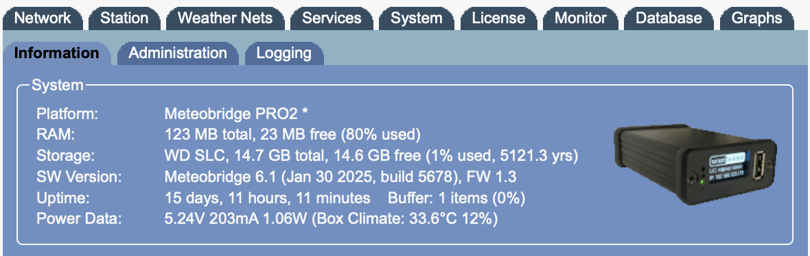

Here is a screenshot of the Info screen showing a seemingly correct "Box Climate" temperature in ℃.
Perhaps a conversion error?
Mike
