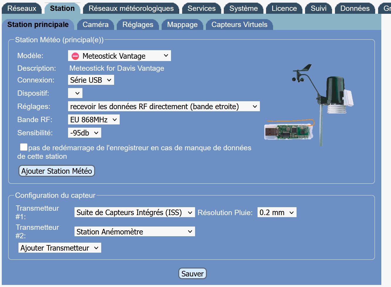

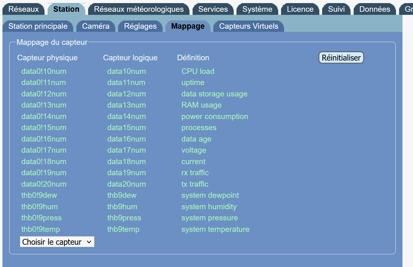

I have a MB Pro (red). Evreything ran perfectly OK until I did a reboot a few days ago. Last one dates probably more than 1 year.
Now I have the impression that I cannot connect my Davis Vantage Pro anymore. I use RF transmission. The MB box is connected to my router with a cable (LAN ?).
I have a few printscreens. Notice the red symbol in front of my station. When I check in the menu the majority of weather stations have this symbol, like No Access. And it seems that I have no data from the station

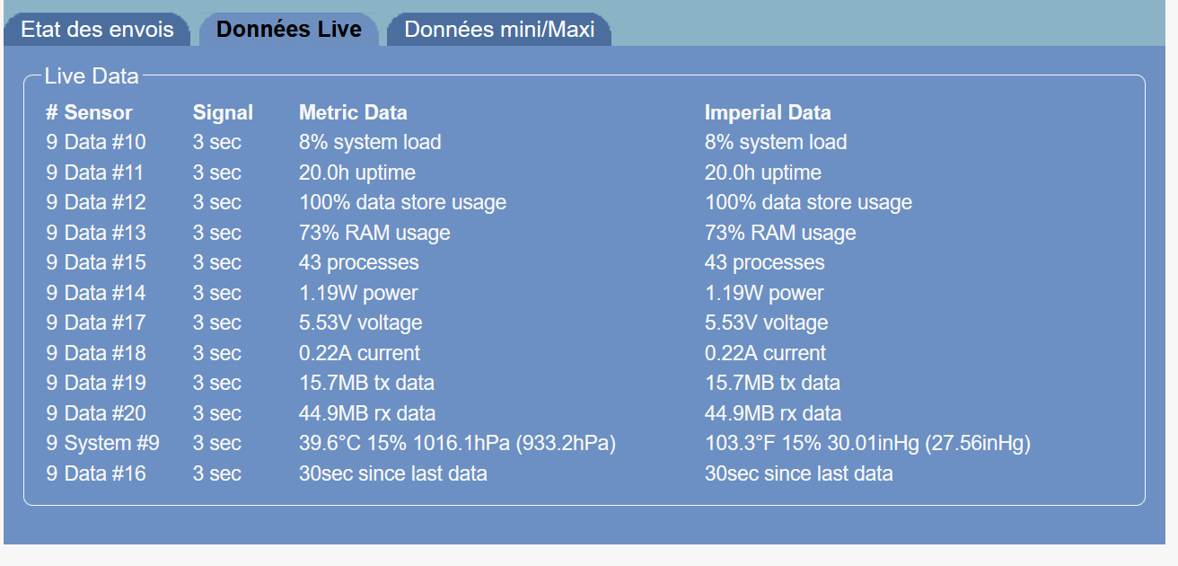

Data storage is showing 100% full?

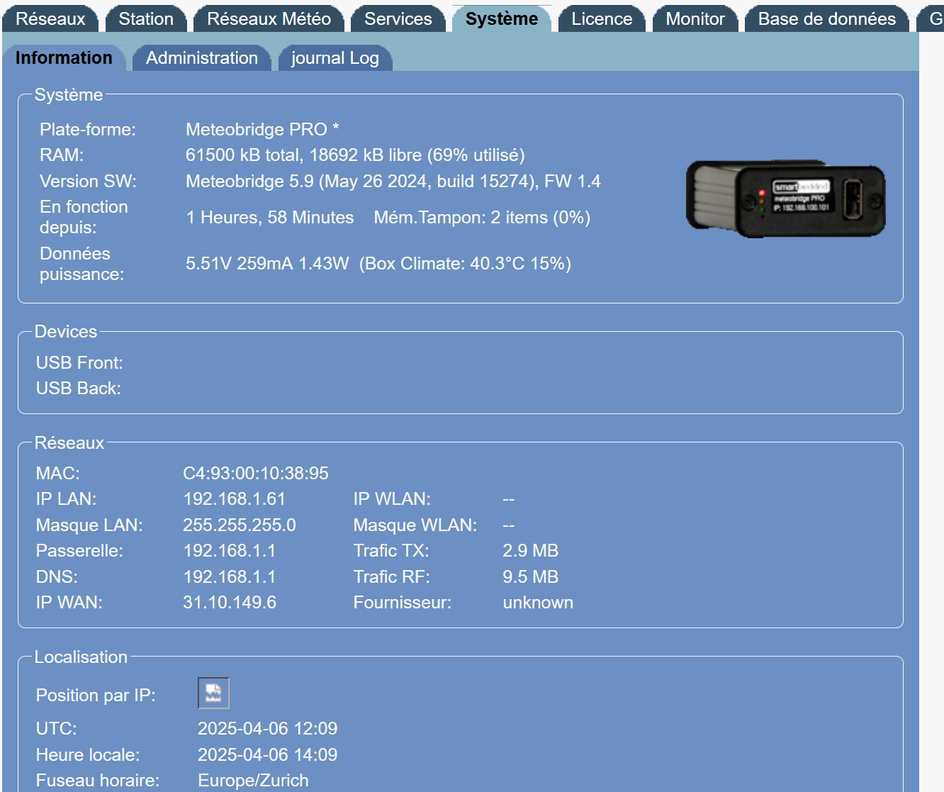

Can you also post a screen shot of your System>Information tab and specifically the top System box, don;t worry about showing the bottom sections?
Re: Seems I cannot reach my Davis VP2 anymore (after MB update?)
Here it is.
I tried a downgrade to 5.9, but doesn't change anything

My Vantage has the symbol. I am getting data no problem.

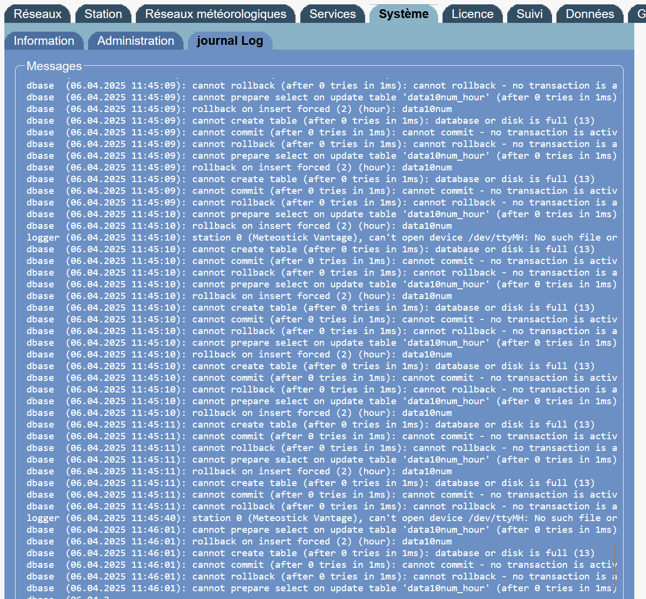

I have exactly the same problem with the same VP2 station, the same Meteobridge Pro (red).
The error messages are also the same.
The problem appeared on 03/30/2025 at 11:17 (without a reboot).
Since then, I haven't found a solution. There is no longer any data saved.
the maintenance section says: Database size: 0MB (0 MB free space available on media)

Your MBPro (Red) is showing as a MBPro (Black) hence probably why RF no longer works.
Storage (USB Type/capacity) is also missing from the last screen shot which could indicate the USB has failed or full?
How old is this MBPro Red? Do you recall what make/brand/size of internal USB stick? What you could try is inserting an external USB and see if it startup normally?

Live data show that internal usb is full.
When i reboot the box it says that format storage failed. The yellow led flashes, no Green led.
I tried to connect to the data file as you suggested and it says No such file or directory
Do you think the usb is dead?

If the unit is trying to format the drive then that tends to indicate a failed drive?

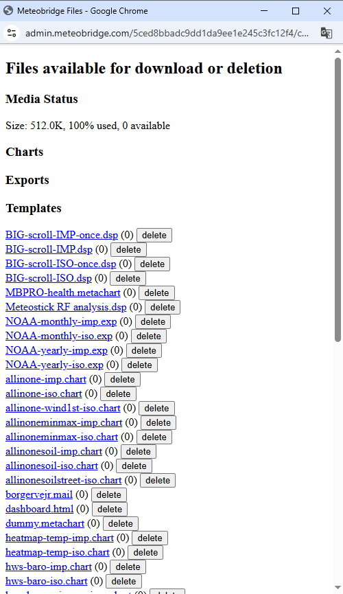

when I run [Download or Delete files], I get the window below. the files are all empty, what can I do?
Is it the same for Exports & Charts?
I only have the page above, no choice of exports or charts
Which to me indicates the other folders have no files yet the drive is 100% full. Another thing is the drive is only 512K, whereas I would have thought most Pro's were 1Gb, at least?
