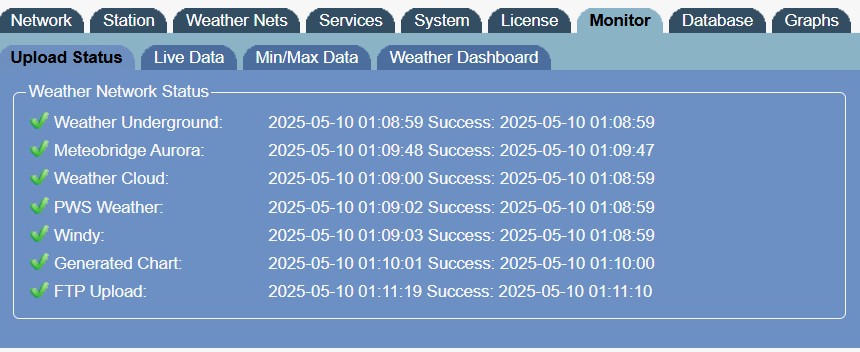

Updated to the latest version with the Aurora cloud dashboard. Couple of times now I have found it has stopped uploading data to weather networks. There is nothing in the log indicating an issue, but the upload status indicates the last uploads were hours ago (and were successful). An example below. Its 7:29am here and the last upload seems to be around 1am. Rebooting usually fixes the stall. I have not rolled back my version yet - but this started directly after updating. Data is still being recorded locally and connections to sensors are good.
Screenshot 2025-05-10 072708.jpg (78.46 KiB) Viewed 8185 times

It was good this morning after a reboot yesterday. The last time, it took about two days until it happened. I changed the upload interval for the Aurora cloud from 2 to 5 minutes, just in case there were too many uploads.
Other than that, not sure of the cause.
