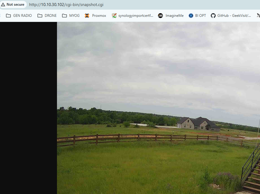

Screenshot 2025-05-15 155559.png (326.92 KiB) Viewed 7764 times
Re: Noob Help Needed - Meteobridge IP CAM
Now we have it working. Issue was, that Meteobridge did not go well with a "$" character in the user/password section. I will release a new version that fixes this.
Working URL:
http://user:password@xx.xx.xx.xx/cgi-bin/snapshot.cgi?channel=1
