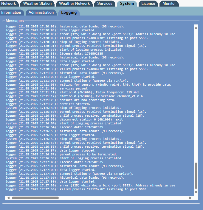

Platokidd
Posts: 20
Joined: Sat Feb 06, 2021 7:17 pm
Re: GW3000 set as primary station ver 6.2 does not work
Post by Platokidd »
Screenshot 2025-05-21 172836.png (106.93 KiB) Viewed 7747 times
Platokidd
Posts: 20
Post by Platokidd »
logger (18.05.2025 09:11:08): data logger started.

logger (21.05.2025 17:18:10): connect station 0 (GW3000 via SW Driver).
logger (21.05.2025 17:18:39): historical data loaded (93 records).
logger (21.05.2025 17:18:39): data logger started.
logger (21.05.2025 17:18:39): error (125) while doing bind (port 5553): Address already in use
logger (21.05.2025 17:18:39): killed process "23955/sh" listening to port 5553.
logger (21.05.2025 17:19:09): historical data loaded (93 records).
logger (21.05.2025 17:19:09): data logger started.
logger (21.05.2025 17:19:09): error (125) while doing bind (port 5553): Address already in use
logger (21.05.2025 17:19:09): killed process "23956/sh" listening to port 5553.
logger (21.05.2025 17:19:39): historical data loaded (93 records).
logger (21.05.2025 17:19:39): data logger started.
logger (21.05.2025 17:19:40): connect station 0 (GW3000 via SW Driver).
logger (21.05.2025 17:20:09): historical data loaded (93 records).
logger (21.05.2025 17:20:09): data logger started.
logger (21.05.2025 17:20:09): error (125) while doing bind (port 5553): Address already in use
logger (21.05.2025 17:20:09): killed process "24083/sh" listening to port 5553.
system (21.05.2025 17:20:31): stop of logging process initiated.
logger (21.05.2025 17:20:31): parent process received termination signal (15).
system (21.05.2025 17:20:35): start of logging process initiated.
logger (21.05.2025 17:20:35): license data: 1710502535
logger (21.05.2025 17:20:36): historical data loaded (93 records).
logger (21.05.2025 17:20:36): data logger started.
logger (21.05.2025 17:20:36): error (125) while doing bind (port 5553): Address already in use
logger (21.05.2025 17:20:36): killed process "24084/sh" listening to port 5553.
logger (21.05.2025 17:21:05): historical data loaded (93 records).
logger (21.05.2025 17:21:05): data logger started.
logger (21.05.2025 17:21:06): connect station 0 (GW1000 via TCP/IP).
logger (21.05.2025 17:21:09): waiting for sensors (wind0, rain0, th0, thb0) to provide data.
logger (21.05.2025 17:21:09): services paused.
logger (21.05.2025 17:21:11): station 0 (GW1000), Radio Frequency: 915 MHz
logger (21.05.2025 17:21:17): station 0 (GW1000), FW version: GW3000B_V1.0.6
logger (21.05.2025 17:21:23): sensors are now providing data.
logger (21.05.2025 17:21:23): services started.
system (21.05.2025 17:26:50): stop of logging process initiated.
logger (21.05.2025 17:26:50): parent process received termination signal (15).
logger (21.05.2025 17:26:50): child process received termination signal (15).
logger (21.05.2025 17:26:50): disconnect station 0 (GW1000): exit
system (21.05.2025 17:26:54): start of logging process initiated.
logger (21.05.2025 17:26:54): license data: 1710502535
logger (21.05.2025 17:26:55): historical data loaded (93 records).
logger (21.05.2025 17:26:55): data logger started.
system (21.05.2025 17:26:56): stop of logging process initiated.
logger (21.05.2025 17:26:56): parent process received termination signal (15).
logger (21.05.2025 17:26:56): child process received termination signal (15).
logger (21.05.2025 17:26:57): data logger stopped.
logger (21.05.2025 17:26:57): parent process to be terminated.
system (21.05.2025 17:26:59): start of logging process initiated.
logger (21.05.2025 17:27:00): license data: 1710502535
logger (21.05.2025 17:27:00): historical data loaded (93 records).
logger (21.05.2025 17:27:00): data logger started.
logger (21.05.2025 17:27:01): connect station 0 (GW3000 via SW Driver).
logger (21.05.2025 17:27:30): historical data loaded (93 records).
logger (21.05.2025 17:27:30): data logger started.
logger (21.05.2025 17:27:30): error (125) while doing bind (port 5553): Address already in use
logger (21.05.2025 17:27:30): killed process "25125/sh" listening to port 5553.
logger (21.05.2025 17:28:00): historical data loaded (93 records).
logger (21.05.2025 17:28:00): data logger started.
logger (21.05.2025 17:28:00): error (125) while doing bind (port 5553): Address already in use
logger (21.05.2025 17:28:00): killed process "25126/sh" listening to port 5553.
logger (21.05.2025 17:28:30): historical data loaded (93 records).
logger (21.05.2025 17:28:30): data logger started.
logger (21.05.2025 17:28:31): connect station 0 (GW3000 via SW Driver).
logger (21.05.2025 17:29:00): historical data loaded (93 records).
logger (21.05.2025 17:29:00): data logger started.
logger (21.05.2025 17:29:00): error (125) while doing bind (port 5553): Address already in use
logger (21.05.2025 17:29:00): killed process "25240/sh" listening to port 5553.
logger (21.05.2025 17:29:30): historical data loaded (93 records).
logger (21.05.2025 17:29:30): data logger started.
logger (21.05.2025 17:29:30): error (125) while doing bind (port 5553): Address already in use
logger (21.05.2025 17:29:30): killed process "25241/sh" listening to port 5553.
logger (21.05.2025 17:30:00): historical data loaded (93 records).
logger (21.05.2025 17:30:00): data logger started.
logger (21.05.2025 17:30:01): connect station 0 (GW3000 via SW Driver).
logger (21.05.2025 17:30:30): historical data loaded (93 records).
logger (21.05.2025 17:30:30): data logger started.
logger (21.05.2025 17:30:30): error (125) while doing bind (port 5553): Address already in use
logger (21.05.2025 17:30:30): killed process "25323/sh" listening to port 5553.
logger (21.05.2025 17:31:00): historical data loaded (93 records).
logger (21.05.2025 17:31:00): data logger started.
logger (21.05.2025 17:31:00): error (125) while doing bind (port 5553): Address already in use
logger (21.05.2025 17:31:00): killed process "25324/sh" listening to port 5553.
logger (21.05.2025 17:31:30): historical data loaded (93 records).
logger (21.05.2025 17:31:30): data logger started.
logger (21.05.2025 17:31:31): connect station 0 (GW3000 via SW Driver).
logger (21.05.2025 17:32:00): historical data loaded (93 records).
logger (21.05.2025 17:32:00): data logger started.
logger (21.05.2025 17:32:00): error (125) while doing bind (port 5553): Address already in use
logger (21.05.2025 17:32:00): killed process "25439/sh" listening to port 5553.
logger (21.05.2025 17:32:30): historical data loaded (93 records).
logger (21.05.2025 17:32:30): data logger started.
logger (21.05.2025 17:32:30): error (125) while doing bind (port 5553): Address already in use
logger (21.05.2025 17:32:30): killed process "25440/sh" listening to port 5553.
system (21.05.2025 17:32:48): stop of logging process initiated.
logger (21.05.2025 17:32:48): parent process received termination signal (15).
system (21.05.2025 17:32:52): start of logging process initiated.
logger (21.05.2025 17:32:52): license data: 1710502535
logger (21.05.2025 17:32:53): historical data loaded (93 records).
logger (21.05.2025 17:32:53): data logger started.
logger (21.05.2025 17:32:54): connect station 0 (GW1000 via TCP/IP).
logger (21.05.2025 17:32:57): waiting for sensors (wind0, rain0, th0, thb0) to provide data.
logger (21.05.2025 17:32:57): services paused.
logger (21.05.2025 17:32:58): station 0 (GW1000), Radio Frequency: 915 MHz
logger (21.05.2025 17:33:04): station 0 (GW1000), FW version: GW3000B_V1.0.6
logger (21.05.2025 17:33:10): sensors are now providing data.
logger (21.05.2025 17:33:10): services started.
Collisions on port 5553 look strange to me. Furthermore, the GW3000 does not even report the connected sensors. This is how it looks like on my setup:
logger (22.05.2025 01:20:58): connect station 1 (GW3000 via SW Driver).
logger (22.05.2025 01:20:58): connect station 9 (System Data via Plug-in).
logger (22.05.2025 01:20:58): station 1 (GW3000), connected sensors: wh85 wh90 wh69 wh68 wh40 wh25 wh26 wh80 wh57 wh45 wh41 wh55 wh31 wh54 wh51 wh34 wh35
Are you using a valid IP address for the GW3000 station definition?
Can you send remote login credentials to "info(at)meteobridge.com"?

admin wrote: Thu May 22, 2025 1:43 am Collisions on port 5553 look strange to me. Furthermore, the GW3000 does not even report the connected sensors. This is how it looks like on my setup:
Yes, I have the correct ip address of my gw3000. That ip address is the same when I use the gw1000 station setting and the gw3000.
Emailed the remote login credentials.
Hope it works
I found a SW bug that has been in the GW3000 code for quite a while... a classic one in C.
wrong:
p = (char*) malloc (strlen (name + 1))
right:
p = (char*) malloc (strlen (name) + 1)
This raises a segmentation fault when working with p and trying to fill up the allocated memory completely (allocated memory is 2 bytes shorter than intended).
Bug fixed version has just been released. Without remote login and doing code inspection on a machine that is impacted by the problem, I would have never found this.
Platokidd
Posts: 20
Re: GW3000 set as primary station ver 6.2 does not work **solved**
Post by Platokidd »
Thanks for looking into this and making the fix! Everything seems to be working as it should now. :D
