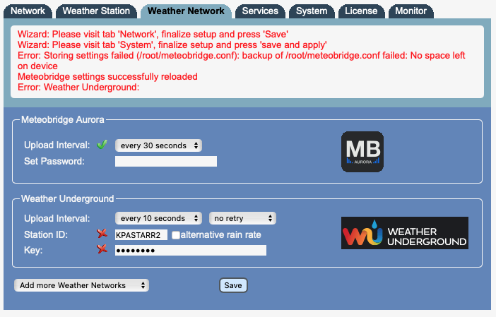

So I upgraded my Lic and the software on my MR3020 (v1) an now it says I have no memory to save preferences, adding weather services, making network or any other change I get "out of memory" and the preference is not saved.

Here is an image of trying to save the settings for MB Aurora.
Screenshot 2025-05-26 at 9.25.13 AM.png (79.23 KiB) Viewed 6683 times
Re: TL-MR3020 (v1?) Running 6.2 No memory
Issue is that internal flash tells being stressed out. When you give me remote access. I can see if I can do something.
Please send credentials to "info(at)meteobridge.com". FAQ explains how to enable remote login
These MR3020 v1 devices are about 10 years old hardware and fail a bit more likely today.

Well it seems the memory is so full can't accept the lic and so I can't even switch to the tab to provide remote access :-(
I have it back up and reporting data to WU. Going to order a Nano SD and call it a day 10 year (TEN YEARS) was a good run and worth the money.
