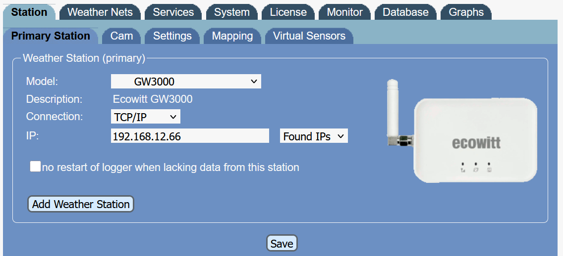

Are you using the GW3000 or GW1000 station selection?

I'm using the GW3000.

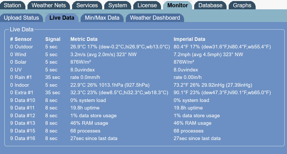

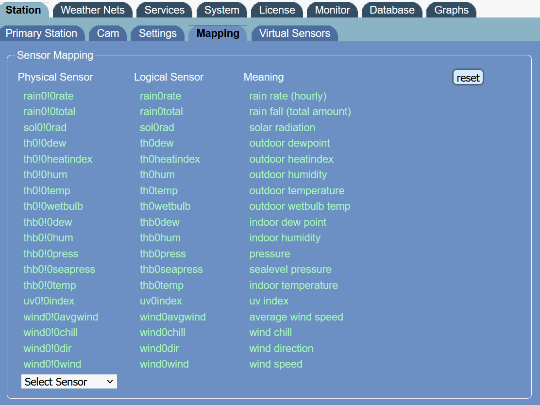

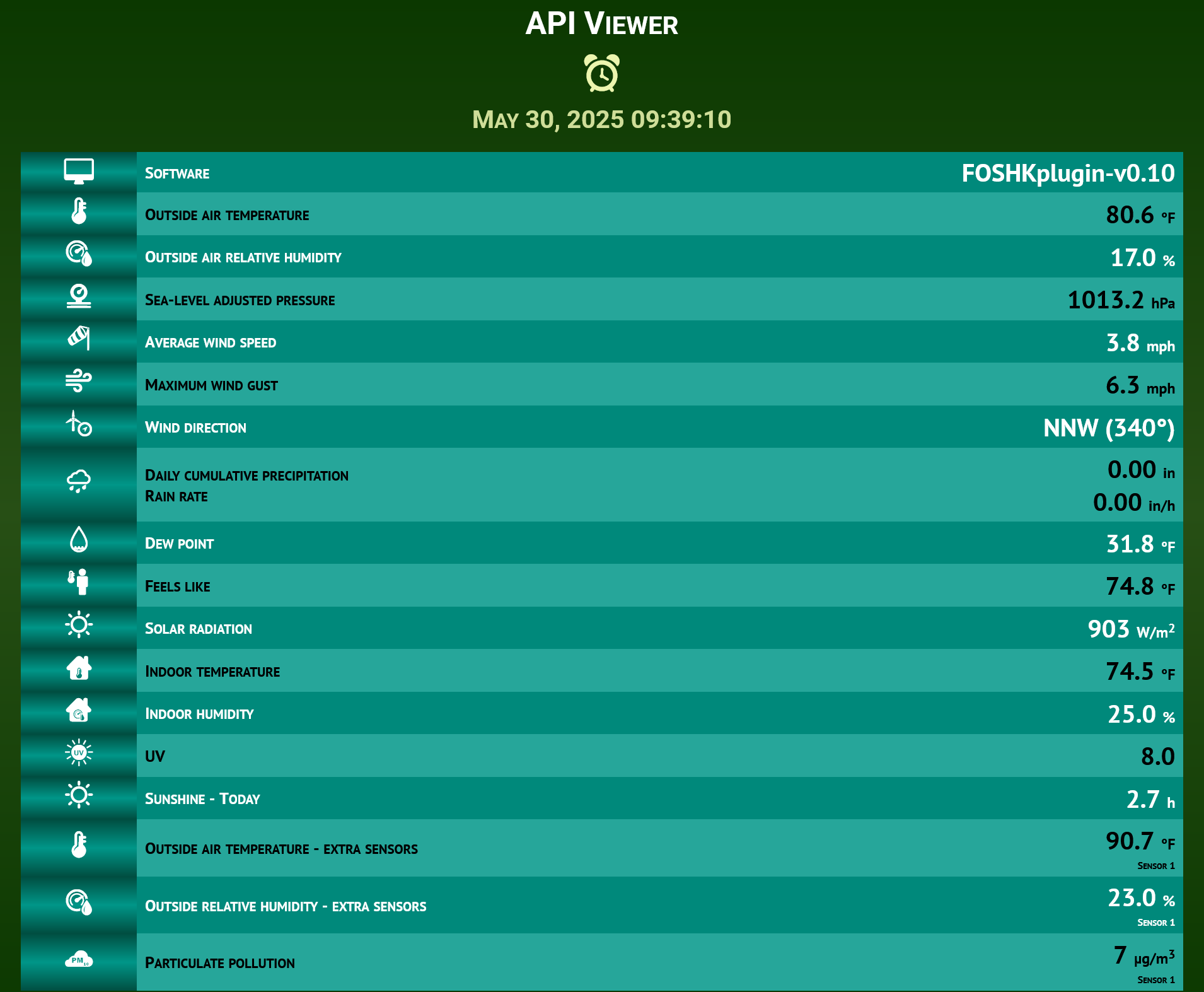

I'm including a few screenshots to hopefully help.
The last one shows what the FOSHKplugin sends to the Meteotemplate API.

Sorry, that still is not populating air quality in the Meteotemplate API. It is populated in the Live Data display.

Meteobridge feeds air0pm to air3pm as PP0 to PP3 to Meteotemplate. Please use sensor mapping on "Station - Mapping" tab to align to your needs.
