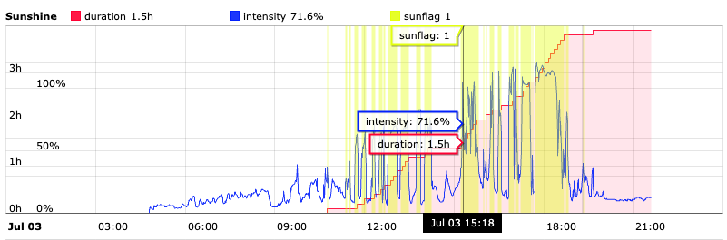

When you have a solar sensor reporting radiation in W/qm you might be interested to give the new sunshine feature a try (https://www.meteobridge.com/wiki/index. ... ersion_6.2). There are two new data sections for sol-Sensors. "solXrate" reports the intensity of the measured solar radiation compared to maximum possible solar radiation given the current point in time and the geographical position derived from longitude/latitude data. Intensity is reported in percent. "solXtotal" reports the number of minutes the sun is shining. Sunshine is defined when radiation intensity is at least 40% and absolute radiation is above 50 W/qm. Both thresholds can be changed, you find them on "Station - Settings" tab.

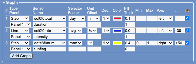

I defined this "sunshine" chart...
Bildschirmfoto 2025-07-03 um 21.33.47.png (33.52 KiB) Viewed 25701 times

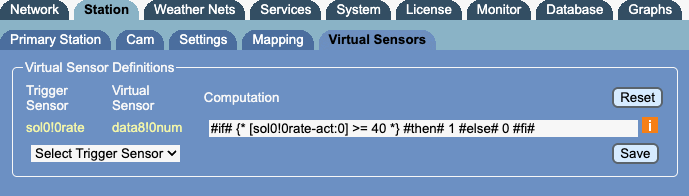

and introduced a virtual sunshine flag sensor like this...
Bildschirmfoto 2025-07-03 um 21.35.06.png (38.83 KiB) Viewed 25701 times
to have a view on today's sunshine in terms of sunshine duration and when the sun was shining.

I tried to do this. When I hover over the "i" icon, it says "value invalid"
I use this:
#if# {* [sol0!0rate-act:0] >=40 *} #then# 1 #else# 0 #if#
The "data8!0num" sensor never is available to choose for sunflag. on the chart define page.
Any ideas?

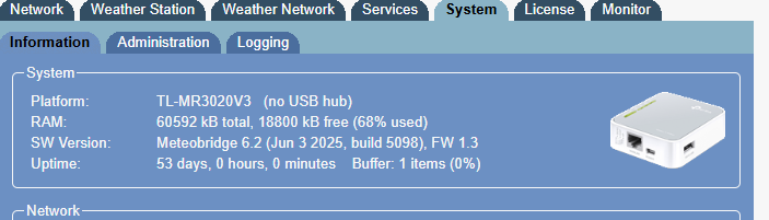

This (not: these) one:
Screenshot 2025-07-23 165556.png (51.96 KiB) Viewed 24890 times
my FW version
Screenshot 2025-07-27 114812.png (32.36 KiB) Viewed 24749 times

Did you define a virtual sensor for data8num as explained in the screen shot?
davidmc36
Posts: 142
Re: Experimental sunshine sensor based on solar radiation data
Post by davidmc36 »
Certainly. I did everything you show but the last drop down does not contain the "data8...." choice.
